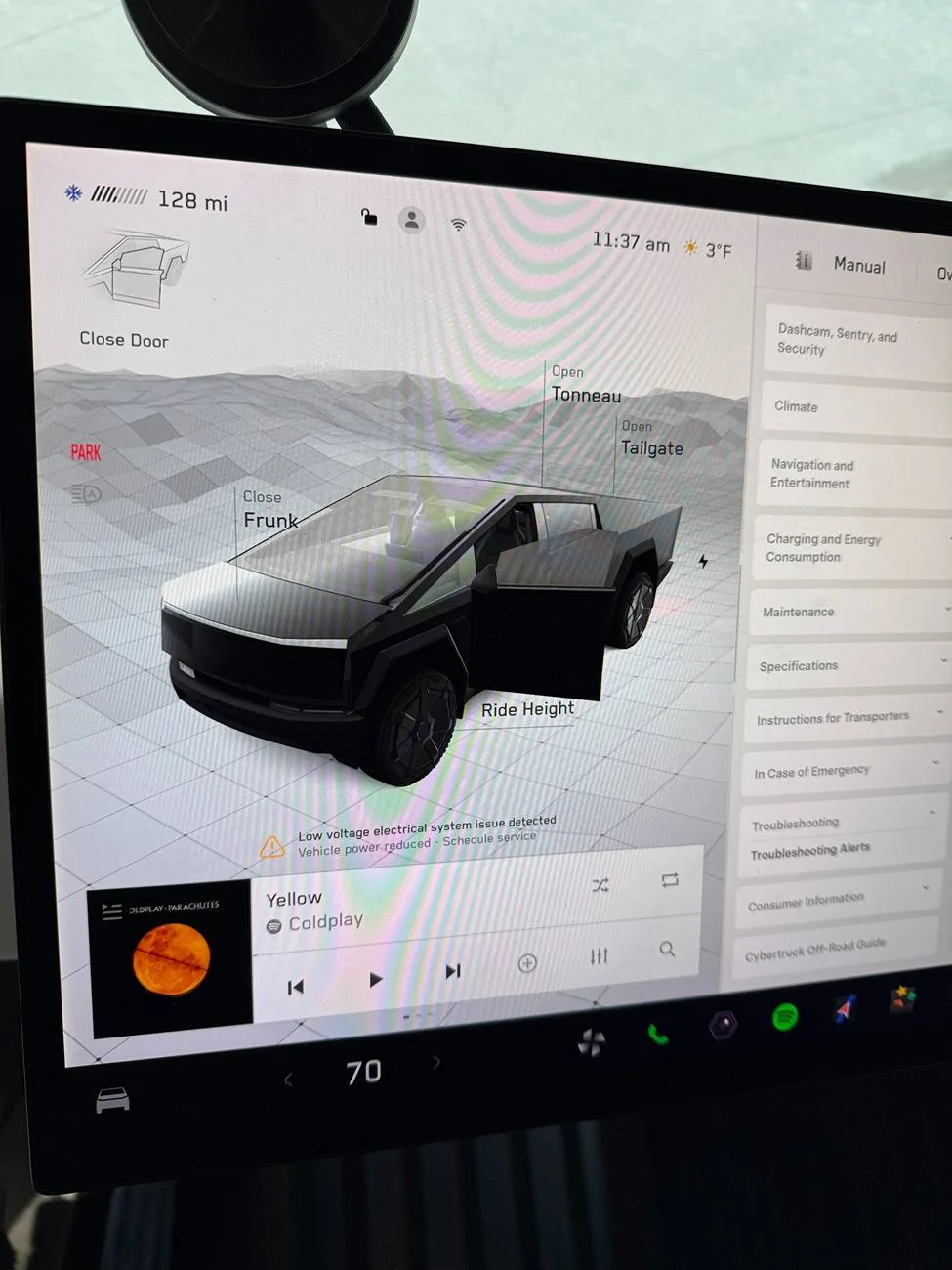

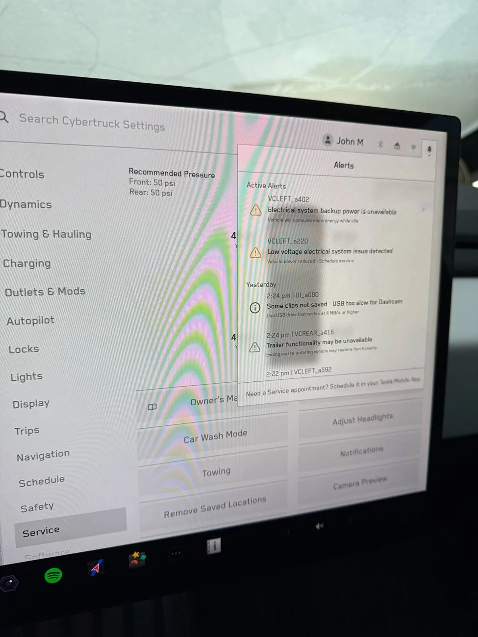

I got the driver-side door open. Took a while and the screen turned on. Tons of electrical errors came up (infinite errors scroll)
I had a tow guy come but he could not take the truck away. The electrical issues are preventing the truck from entering into "TOW MODE".

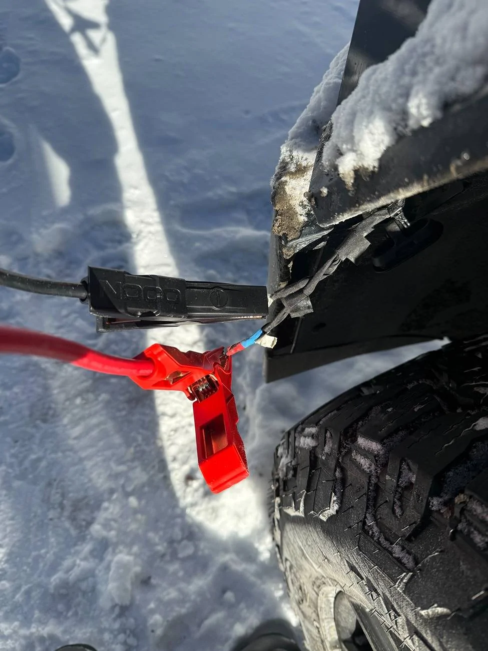

Is there a way to read the 48 low voltage battery voltage on screen?
Did the tow truck driver have a way to apply 48 volts to the battery or charge it?
if this was a ICE vehicle, first thing would be open hood, check battery voltage and jump or apply correct voltage to it.
I see no reason why not to treat this the same, but that’s coming from a retired mechanic.

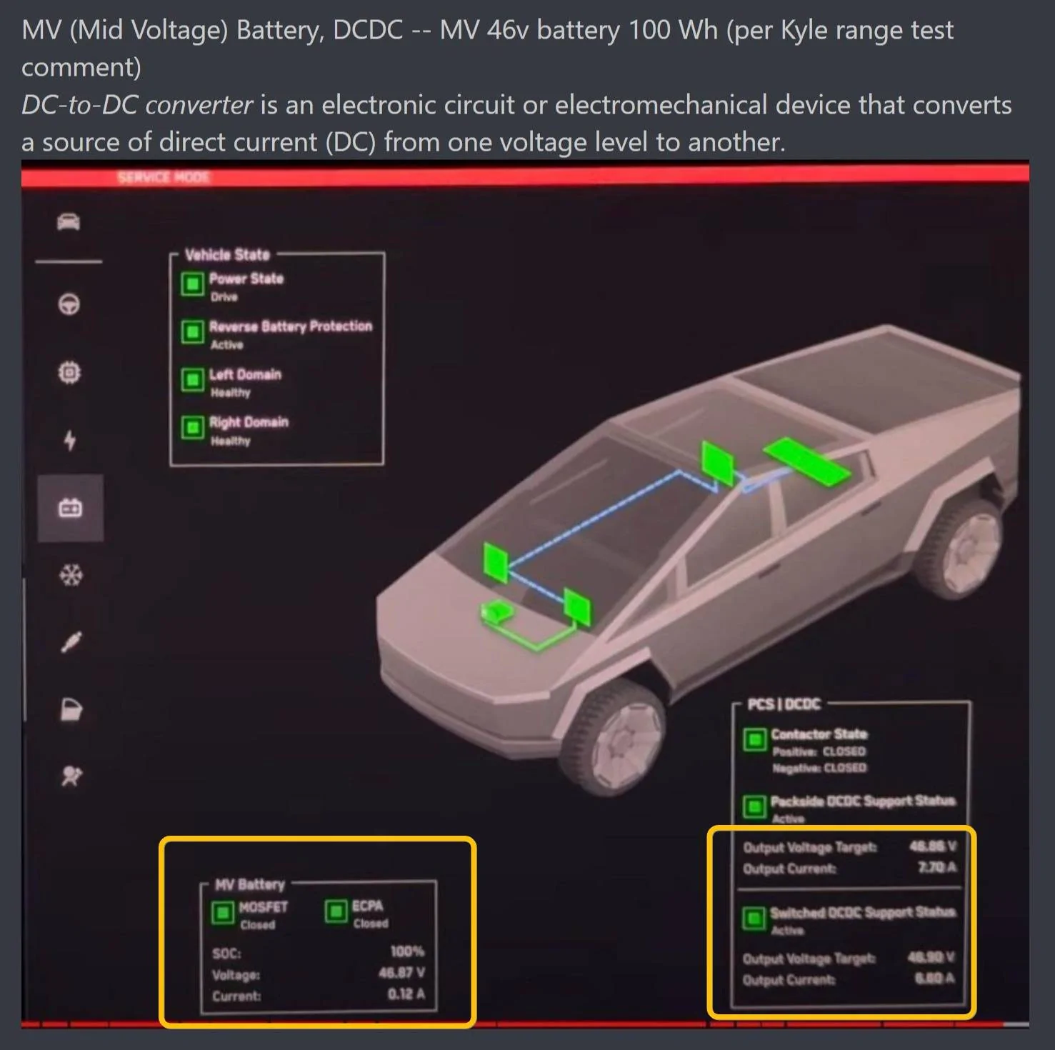

Some 48V MV info in the service mode panels:
(via my thread on it in my signature)

I'm fuzzy on how the system works if you apply 28-48V to the jump post. Seems like that would directly power the 48V bus, in which case the 48V battery can't get directly connected due to likely voltage imbalance. Unless the left controller then uses its DC-DC to feed the MV battery.
Otherwise, post to start 48V bus, wake HV pack and let PCS run 48V, disconnect jump pack, PCS sets voltage to match MV battery and MOSFET gets closed...
Interesting passage in the manuals:
"If you are using a variable power supply, set the supplied voltage to a value between 12V and 16.5V or between 30V and 50V."
