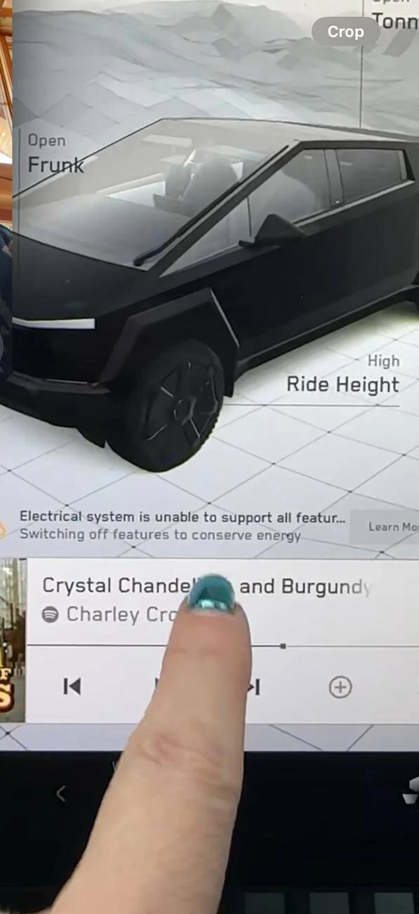

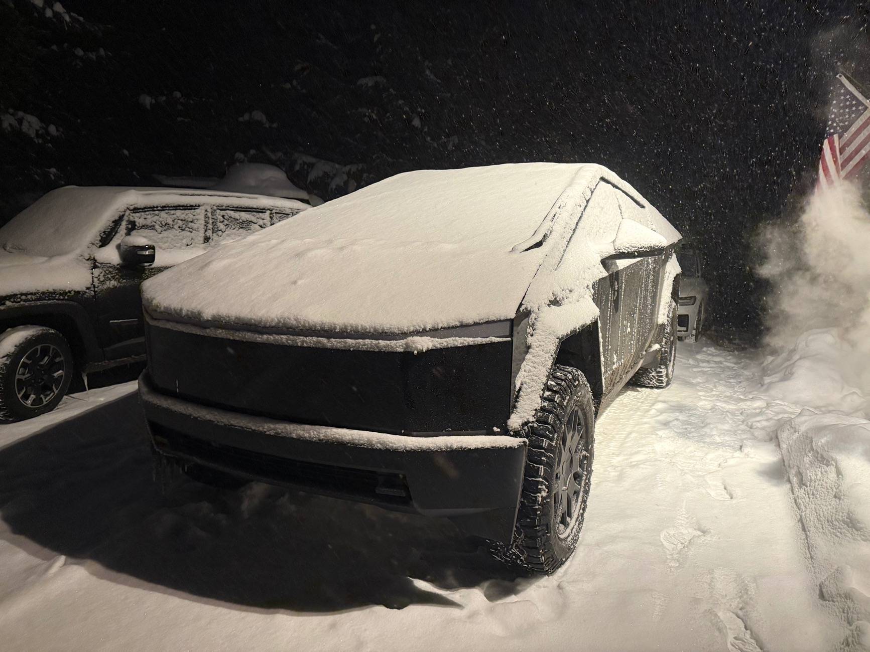

Cyber truck, 40% charge is not responsive to me. App won’t unlock it, key cards aren’t working. Stuck on a snowy driveway Truck doesn’t seem to react in anyway. Earlier the car had a message when I was getting out that “electrical system unable to support all features”. Yet it has 40% charge.
Any ideas? I tried honking the horn etc and nothing works at all. I tried entering in rear doors, passenger side, pressing the charging port button - nada. It is very cold at the moment but it drove fine today.
Could the battery deplete but not adjust the charge on app / screen? Trying to contact Tesla now.

Tesla unable to make remote access to the vehicle. It’s bricked. All my stuff inside it is unable to be accessed. They will have to bring it to a service center somehow - which isn’t available until Monday. Welp, this sucks.

Tesla confirmed it’s not a depleted battery on their side (sorta was hoping it was that but nope). Tow truck in route. It’s currently 9 degrees. Wonder if something to do with it.
That is referring to the low/mid voltage system.
