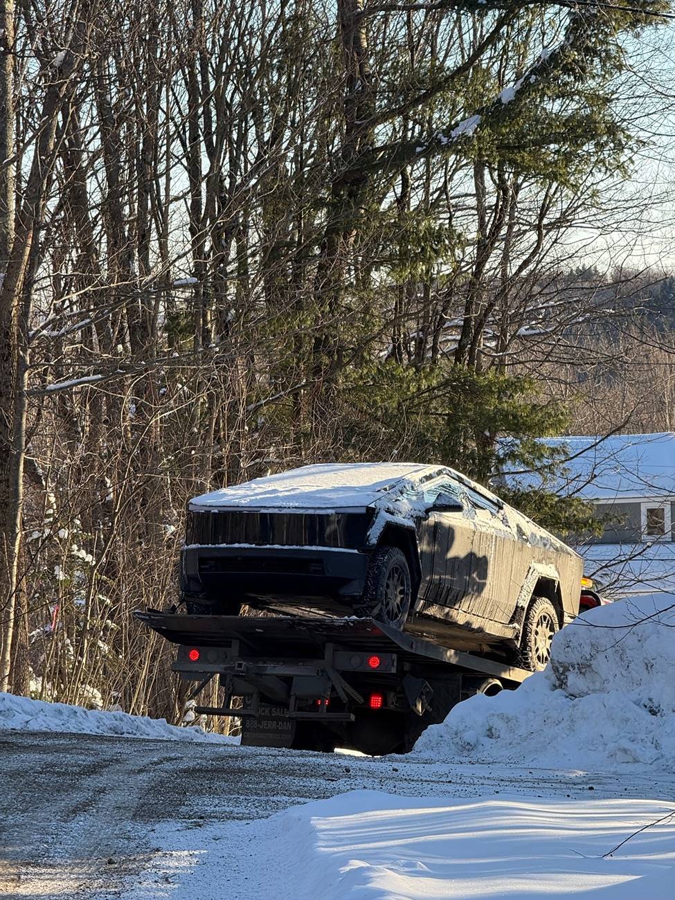

I had a tow guy come but he could not take the truck away. The electrical issues are preventing the truck from entering into "TOW MODE".
We tried everything in terms of charging, etc to get the TOW MODE button to activate but no go. Also, the truck is sitting on snow and ice isn't helping his confidence. The tow truck left, and he seems to be thinking about how to solve it / if he can do it.

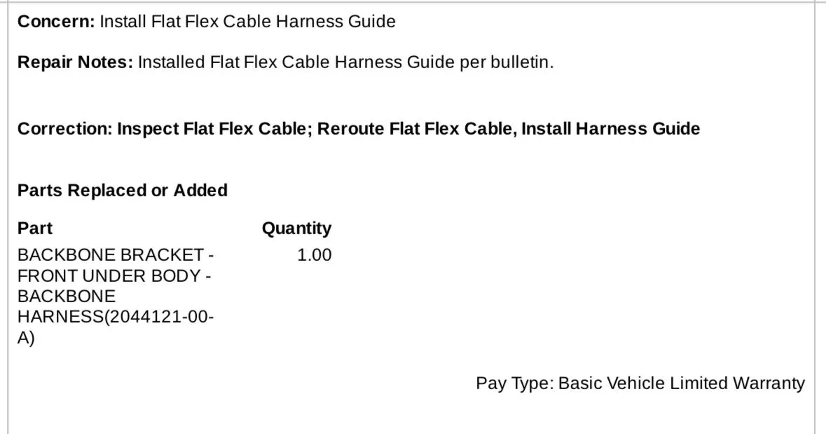

I had the exact same issue. Here are some screenshots of the fix required for my truck. Took about 10 days at the service center. The good part is I got the new wiper motor part number and sail appliqués on the top side of the truck bed on the same visit.
Wheel dolly or
skid plates (or drag) and flatbed.
