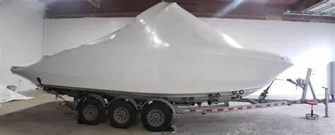

I'm sure you would get better milage if your boat had a cover or something on it to avoid parasitic drag. Not sure if shrink wrapping a boat is cost effective or another alternative is available.
