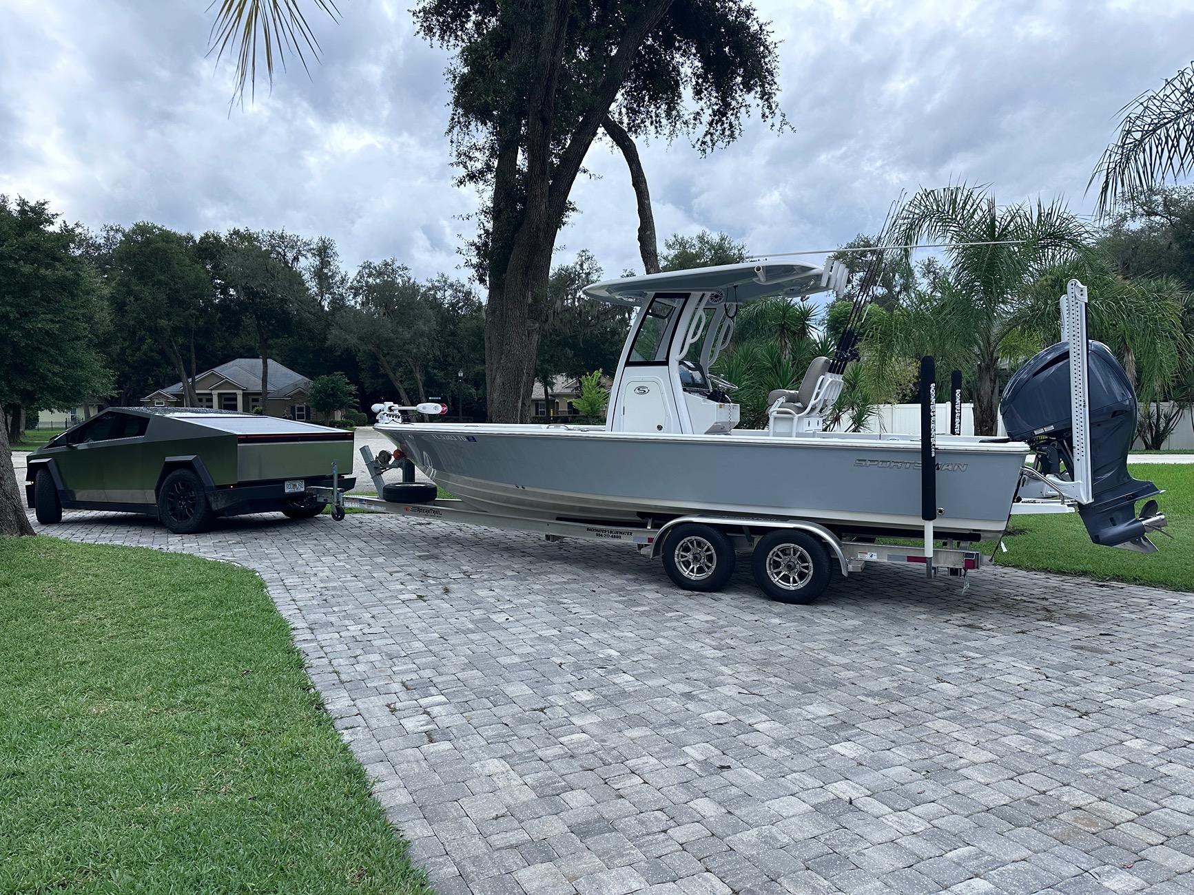

Aerodynamics play a huge role. Do you have a picture of your setup? Did the boat have a cover on when towing?
Also, the range extender is being made for this specific reason...
Tesla Roadster 2nd gen Miserable Towing Experience - NEED HELP! (Updated) IMG_3085

Just posted a picture of my setup. I am actually heading back down to Marathon in about 30 days from now. I will try to pull at 55-60 MPH but this is Florida and the closer you get to Miami the crazier the drivers become. How about the height settings?

I would run at the default height. I doubt it will make much difference vs forcing it into a low setting. It's too bad that captains "cabin" doesn't fold down. :ROFLMAO:

langenbahn suggest you add your beautiful CT & Boat pic to your profile as your pic. Just click on you nonexistent pic icon and Edit Prole and update it with the CT & boat pic.
As to the drag the boat creates. It's not so much the front of the Captains Cabin but the rear and how the air that is separated by the front gets put back together. In your instance the Captains cabin does a good job in separating the air in the front but it really increases your drag coefficient by not reassembling the air in the back of the Captains cabin.
If you were to fold the Captains cabin either forward or rearward and get it as low as you can into the boat the only thing you would be left with is the motor but that already has some aerodynamics to the design so not much you can do there.
That white stick sticking up is another drag on the forward motion is if that can be removed and placed in the boat you will be well on your way to making your tow as aerodynamically as possible.
Also what SSonnentag said about speed is 100% correct. The faster you go the significantly more energy you will need to move at speed. Your drag coefficient will increase with the square of your speed. Keep it at 60 and you will significantly reduce your energy consumption and your Watts/Mile will go up.
Just because you can go fast doesn't mean you must go fast, especially when pulling a trailer. Keep the speed in check, 55-65 at best, and save $$$ and live longer.
Good luck and keep us posted.

Not sure if you are joking or not about folding the "Captain's Cabin" in, but that's not really a viable solution.
The default height is the lowest driving setting.
