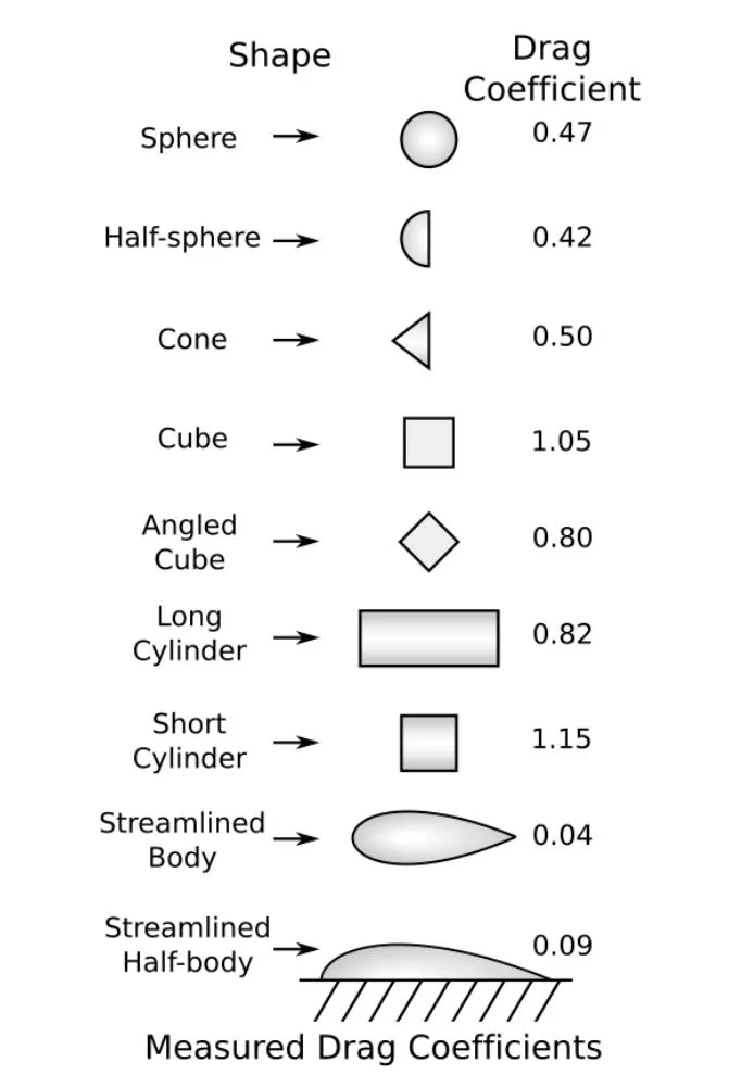

Ok... Heading out to the forum to solicit some advice. Does anyone think I could make a material impact on range while towing my center console by adding a wedge in front of the boat wind screen? I was thinking about making a wedge out of plywood and 2x2's and affixing it to the windscreen before my next trip to the keys. I am envisioning something that would extend from the bench seat to the hardtop creating a wind wedge which would be about 2 feet thick.
Thoughts?
Thoughts?
Yes
Though I might look at using pvc pipe as a bendable lightweight frame and a tarp to shape both the leading and trailing airflow from the pilot house. Shrink wrap would be ideal, but impractical.

I hadn't thought of PVC. That is a great idea.
Any thoughts on potential percentage range improvement?
I once heard that the wheel covers on my model 3 increased range by 10%.
Well, rolling drag is about 2Wh/mile per 100 pounds, so the rest is aero. Here are drag coefficient comparisons from Wikipedia:
