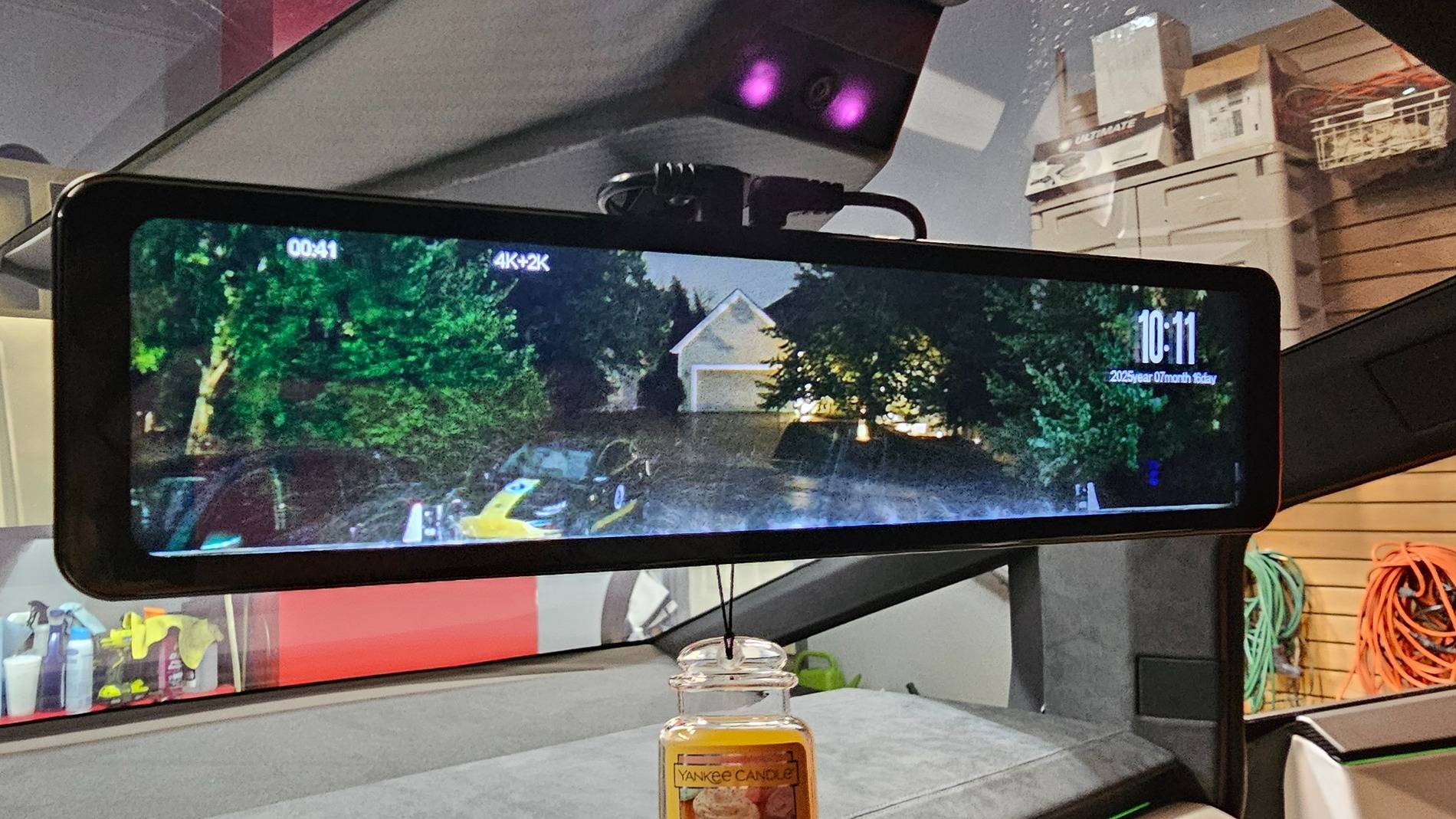

Have I got a treat for you! Pic and Videos of testing in the rain!
Dude you're awesome, you literally read my mind.... I came to this thread to ask you for updates and to make sure you still like it or any issues/problems with it. I ordered the exact same one - just waiting for it to arrive. Thank you, I appreciate it.

Installed my version “3” today. Took some video, tbh it does show much additional to the original posters video, but it might add a different perspective.

I’m currently still finishing up my review of this mirror; and I was also noticing the rear camera seems warmer toned, and almost seems worse than the front cam. I still need to pull footage off the SD card to compare the raw footage though.

what type of adhesive do you guys use to glue the camera & the cover to the plastic trim?
TeslaKen
TeslaKen
Ken
Apr 26, 2024
1,093
1,578
Overland Park
www.halocybertruck.com
Currently Occupied
I guess I forgot to.show that in my video or that segment had an error in recording but basically I bought some of that 3M automotive adhesive tape at a local Autozone auto parts store and then cut pieces to fit as needed. Super simple.

I used some random 3M double sided tape I had lying around. I may consider re-printing the camera cover to put some slots in the first layer for the double-sided tape to fit so the cover can fit 100% flush with the cross bar. I don’t think anyone but me would notice, but the double sided tape does make the camera cover sit a little bit above the surface of the cross bar at the top of the toneau cover. Also, my camera was a very weird shape so I ended up having to hog out the inside with a dremel. If I reprinted, I would try to modify the internal structure to fit the camera exactly.
