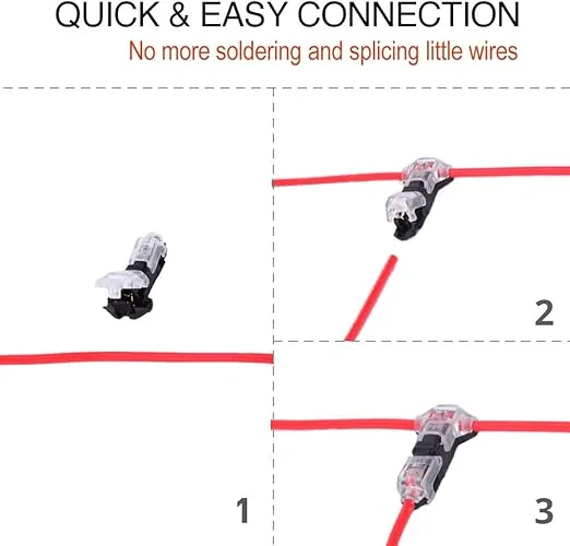

if you are using Hansshow mirror, just tap power from the wires which supply power to the mirror,
you can also use "Quick Solderless T Tap Connector"
it look like this
