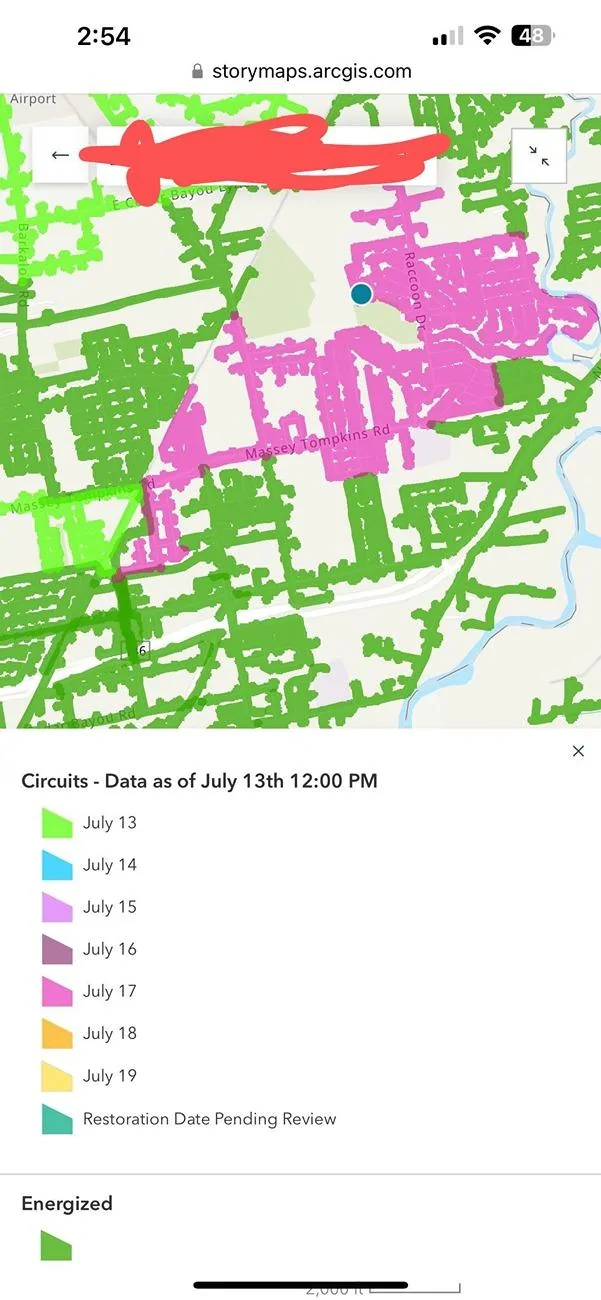

No power, no internet, no hope...
Just got the word it's another 4 days estimated. I'm looking forward to Monday when it's headed for upper 90s and a feels like in the 110 area.
