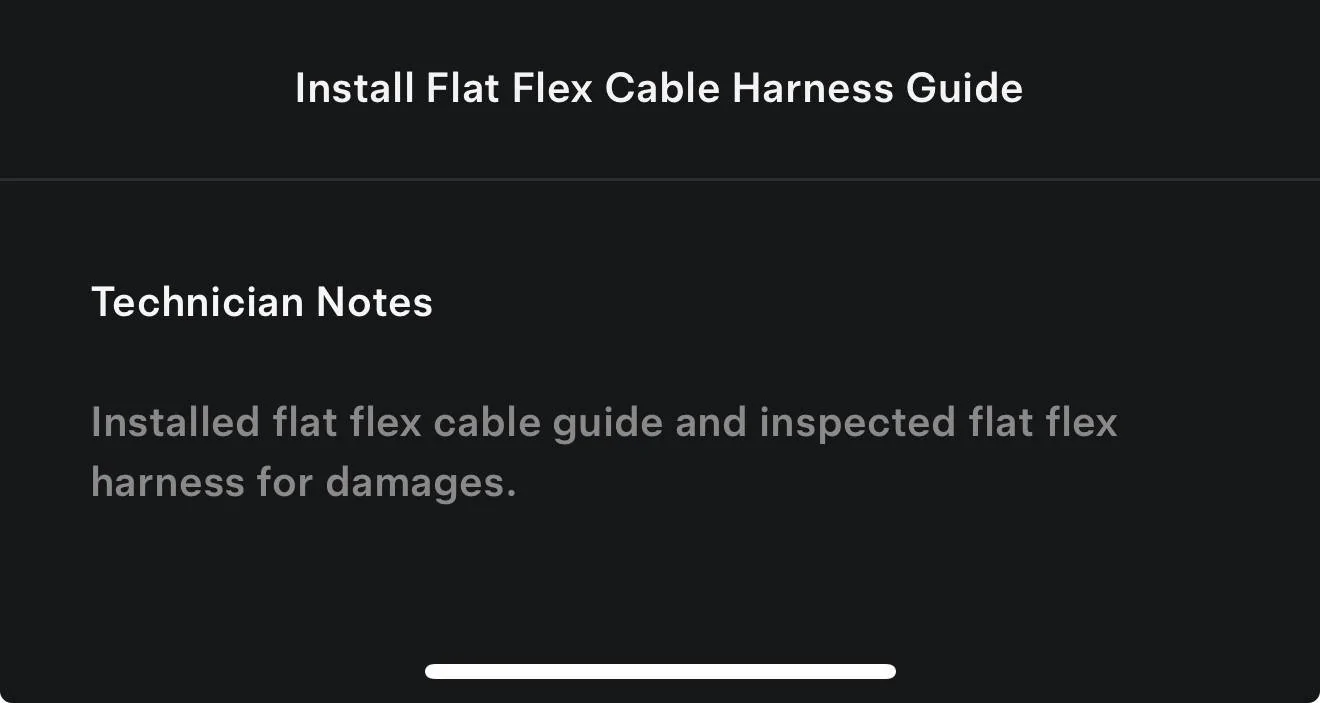

Hi all, have the mobile service guy(s) out here now replacing my left/right bed rails and wiper motor, also hopefully getting ready of the extremely creaky console creak versus my stuffed rag solution.
On top of that, they also added a "Flat flex cable harness guide" in where a number of the trucks don't have a cable routed properly down the middle, and it is causing them to flex, crease, and crack open, then sparking against metal frame/other, causing electrical issues. Common occurrence it seems to justify a service bulletin. The process is to undo the harness and reroute it property if required.
Anyone else have this done? Unfortunately the poor guy has to remove half of the truck and inside to get to it to fix - which has me feverous that I'm going to get a truck back in a few hours that rattles and isn't quite the same, ug.

One of the reasons I dont want them doing that bulletin .. I keep postponing my SC appointment.

Had mine done about two weeks ago, when I brought it in for rotation.
I can't even tell they were in my CT.

Just had mine in for service and asked them to skip this one as they said it was the first one they had in for this.

I'm taking mine in tomorrow for the cable, front / rear inverters and a few other things. After looking at the service guides for these things my truck is pretty much going to be stripped and rebuilt with a few "missing" bolts :(

Mine was replaced and I'm positive I'm hearing a new cracking/creaking noise when slowing to a stop.

Now that I think about it, I also had my trim lights replaced. That very well may be what is causing the sounds.
