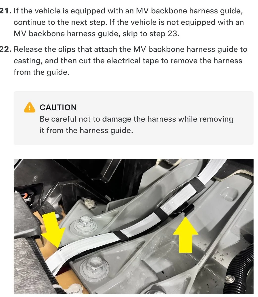

That's the cable that runs along the floor and connects the right and rear control modules.
Procedure:
https://service.tesla.com/docs/Serv...004_Install_Flat_Flex_Cable_Harness_Guide.pdf
Tesla Roadster 2nd gen What is flat flex cable guide? SmartSelect_20240923_174528_Firefox
