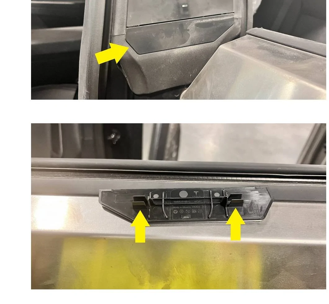

One caution/ I prayed the door button off and ripped the two sided tape holding the glass door button in place. Ask a service tech to show you where you should pry to reveal the single screw holding that panel on where you make the plug connection. I tried using double sided tape to reattach the door button but finally took it to the service center and they replaced the entire panel under the warranty
3,489
3,010
Two links down from lightbar install.
https://service.tesla.com/docs/Cybe...UID-6C2570AA-34B9-4BBD-991E-E63CEF5FAFCF.html
Tesla Roadster 2nd gen Ditch the Lightbar? SmartSelect_20250501_112332_Firefox
Why did you need to remove anything from the B-pillar?
The updated install procedure requires the owner to mate two connectors in the B Pillar instead of soldering wires on the roof.
Tesla Roadster 2nd gen Ditch the Lightbar? 1746139303248-sh

New lightbars come with connector, older ones eith bare leads should get soldered by service center (used to be DIY). Step 22 is where it branches.
service manual
oh wow, I'm glad I have the older method available haha!
