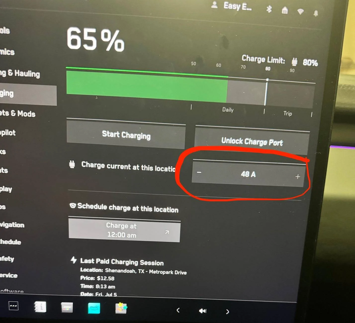

is this set to 2 amps?

The charger is part of the Cybertruck. The wall or mobile connector is a fancy GFCI breaker that tells the vehicle the maximum current allowable. Test number is the second value in 2/32. 32 Amps available, vehicle drawing 2.
I think 5 is lowest that can be set to.
