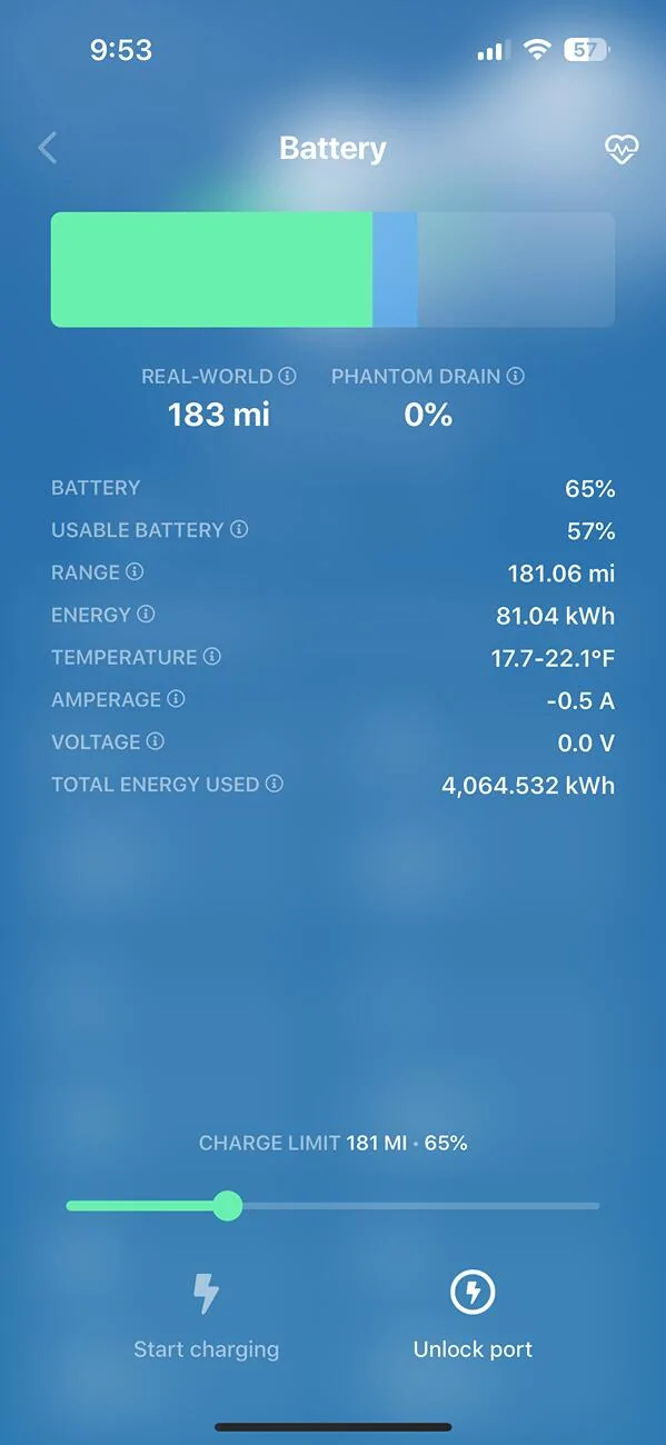

Here in the mid-Atlantic we've been experiencing unseasonably cold temps the last few days. Highs in the 20's (F) during the day; and single digits at night. Not quite as cold as the OP, but within spitting distance.
When I came home from driving my CT yesterday afternoon the pack was ~65F. I plugged in and replaced the ~20 kWh I had just expended, while the pack was still warm. During the nearly three hours that charge took (like the OP, my TWC is on a 40-amp circuit), the pack retained most of its heat (it lost maybe 8-10 degrees).
Fifteen hours later, after sitting outdoors overnight (no garage), the now cold-soaked pack modules ranged from 17-22F.
I remotely turned Climate on and in about an hour the pack temp had risen to ~55F. I don't pretend to understand Tesla's BMS algorithm - some variability is evident - but typically I'll see about 7 amps, with occasional brief excursions to ~10 amps, when using Climate in that fashion to warm the pack.
What's clear is that, even when a full complement of kW are being delivered, there are obvious limitations to how fast a modern Tesla can heat its pack once that pack has become truly cold-soaked. Tesla has engineered an ingenious solution. But fast it's not.
My recommendation to anyone managing an EV in cold temps is to charge immediately upon returning from a drive. Whatever savings might otherwise be on the table with middle-of-the-night charging are almost certainly lost when conditions are such that pack temps fall precipitously.
Yeah, heating while plugged in is anemic. It can be fast, but they reserve that power level (16kW+) for on the road Supercharger preconditioning.
Agreed. When one deals with negative degrees in garage on a regular basis and one is done driving one charges immediately. It is a psychics thing. Pack get cold, pack needs to warm up to charge. Doing post driving increases the likelihood of a warmer pack.
