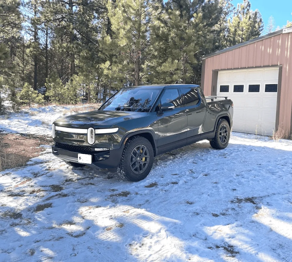

Did a trip back in November of 2022 with the Rivian and stayed up at 10000 ft at 20 degrees with a 110v charger only. It was able to pull 1-2 miles of charge per hour on that. Hoping the CT can do the same.
