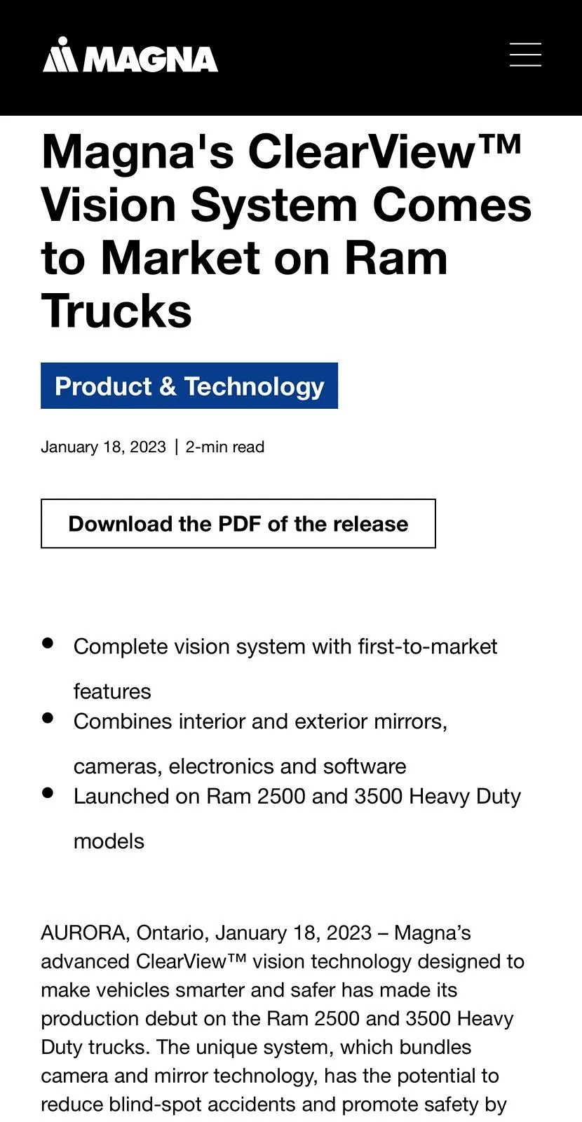

It’s currently available on RAM 2500 and 3500 trucks

This is promising. My plan is to install something similar but, perhaps, a bit more configurable. That rearview mirror base is the perfect mounting point for a user-configurable infocenter and video monitor. I plan to build mine from scratch but, if my excitement is any indicator, I suspect there will be many, many aftermarket accessories publicly available for purchase or projects on instructables.
Since you plan to build something from scratch, Do you think it would be easier to use the Magna Clearview and figure out how to wire it into the existing CyberTruck camera hardware
