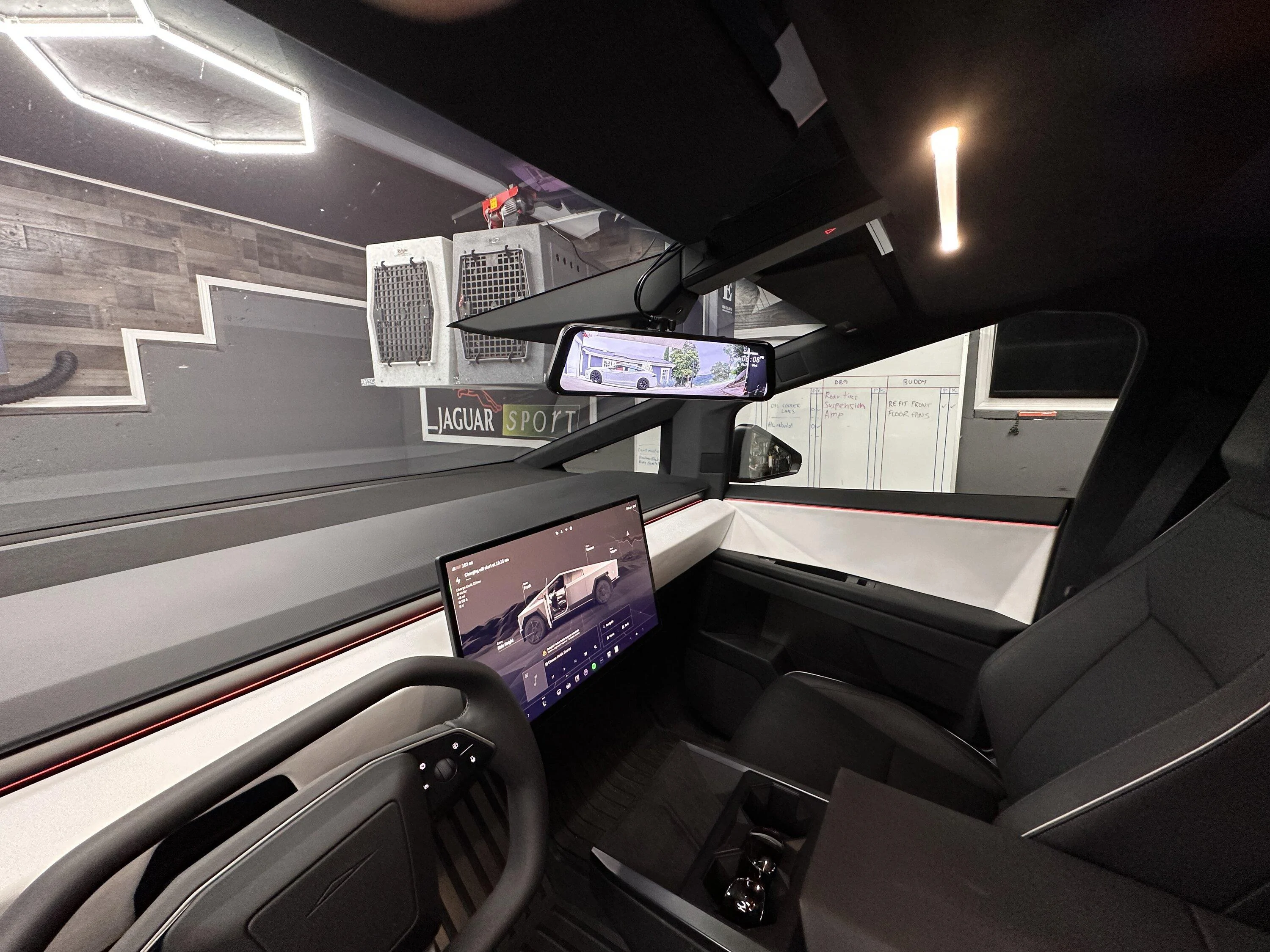

Cheap and cheerful solution.
WOLFBOX 12" 4K Rear View Mirror... https://www.amazon.com/dp/B0B1LLMCS9?ref=ppx_pop_mob_ap_share
I used the online service manual to work out how to remove the interior trim panels, the window seals and rear wheel arch liner. In summary, you don’t need any tools to do this at all. Everything just pulls off. Power is ran from the front USB-C outlet in the center console through a usb-c to 12v cigarette lighter adaptor
CERRXIAN 1ft USB C Male to 12V 8W... https://www.amazon.com/dp/B0BGL8ZRCS?ref=ppx_pop_mob_ap_share
I had to get an extension cable as it didn’t quite reach with the original cable.
NOCO GC019 15A 14AWG 12V Adapter,... https://www.amazon.com/dp/B00G8WLX14?ref=ppx_pop_mob_ap_share
Both cables (power and rear camera) run along the headlining then down the pillar trim. The power cable keeps going down to the floor then goes under the kickplate and under the front seat to the center console. The camera cable goes along the window tops by removing the window seal, then putting it back in on top of the cable. The cable then goes down the rear of the back door, under the rear fender and round inside the wheel arch trim. At the back of the rear fender I pulled the fender liner off and routed the cable through there to the tow bar, then put the fender liner back. The camera itself is stuck then zip tied to the tow bar bracket.
Small details
The usb-c does power off when the car shuts off (usually about 20 minutes after you leave it, assuming sentry mode is off)

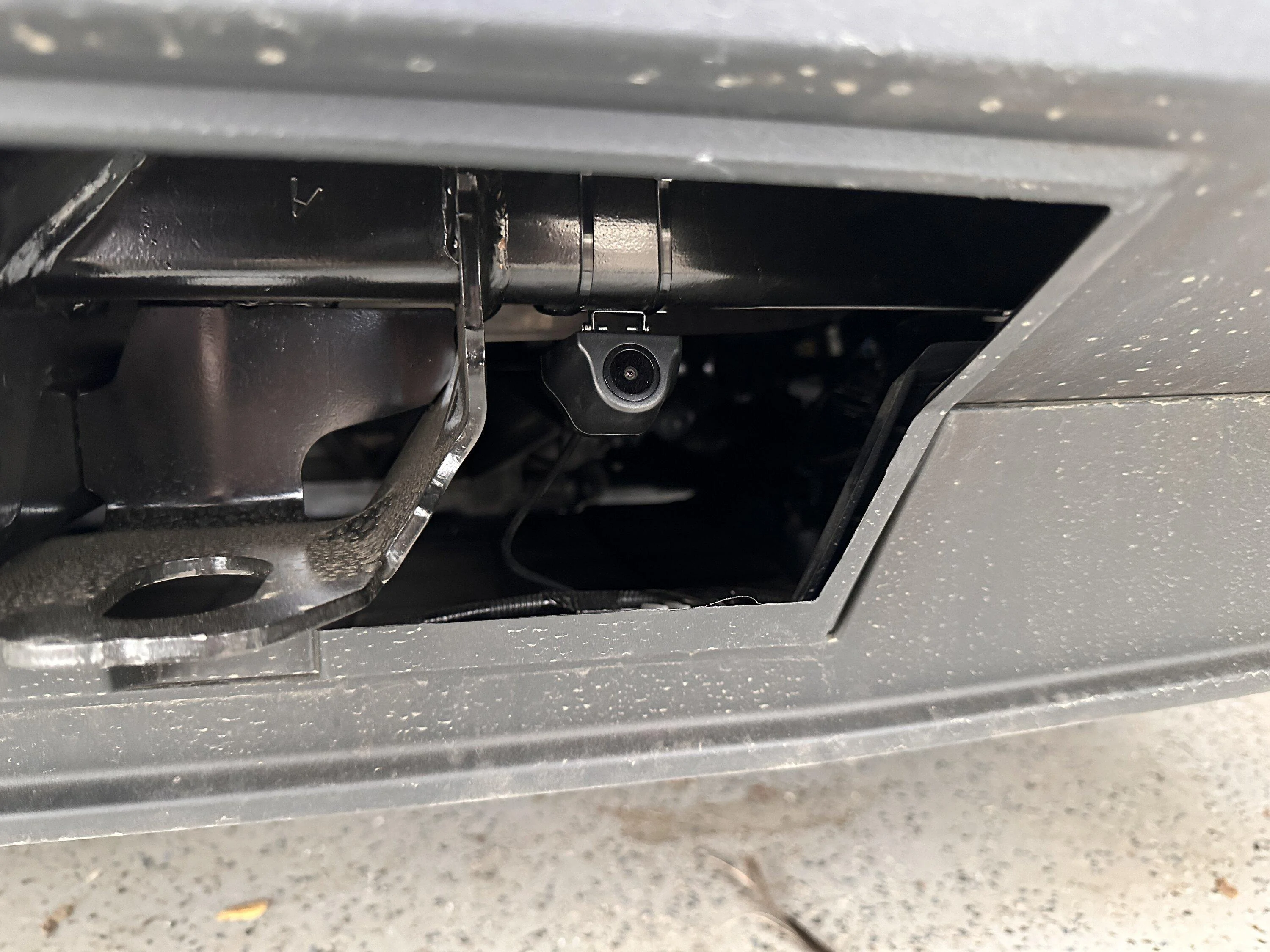

There is a wire on the camera loom that you are supposed to connect to the reversing lights to trigger the rear camera. You don’t need to connect this to anything. Instead you can just select the rear view on the mirror and it stays like that (even through power cycles)
As the cybertruck mirror is really small, I needed to use a piece of foam between it and the digital mirror, otherwise the straps that are used to attach the digital mirror are too loose and the mirror rattles around.
This mirror has a gps attachment, used to give positional info to the dash cam it has built in. I didn’t connect this because I’m not interested in the dashcam feature for this application.
The front camera is 4k, the rear camera is 1080p. Image is still clear enough though.
PROs
It works.
Image is clear and field of view feels right.
Cheap (less than $250 all in).
Only took a few hours to fit.
Completely reversible if needed (I didn’t drill or cut anything, or tap into any wiring).
You still have a rear view mirror even when the tailgate is down (unlike the native camera).
No wiring visible on the outside of the truck and I didnt need to work out how to route a wire from the cab into the bed.
GOTCHAS
You can see wires inside the cabin at the top of the mirror for a few inches until they tuck into the headliner. I tried but failed to route the wires underneath the roof console (the thing with the hazzard button and drive selectors). I took it off but it is really packed inside there and I couldn't get the wires ran and get the roof console to clip back in.
You need to run with your tow bar cover off (We do anyway because we do tow with the truck)
It won’t work if you are towing, meaning you get an excellent view of the front of your trailer and nothing else (when towing we used the full camera view on the main touchscreen and that was fine)
I’m not sure how the camera will fare down there with regards to getting dirty. Maybe it’ll be ok because it’s kind of sheltered, maybe not. Time will tell.
The mirror shape is kind of rounded. A Cybertruck no-no ? Maybe someone will make a nice angular Cybertruck version at some point!
A wireless-Bluetooth camera would be more desirable for me when towing my camping trailer.

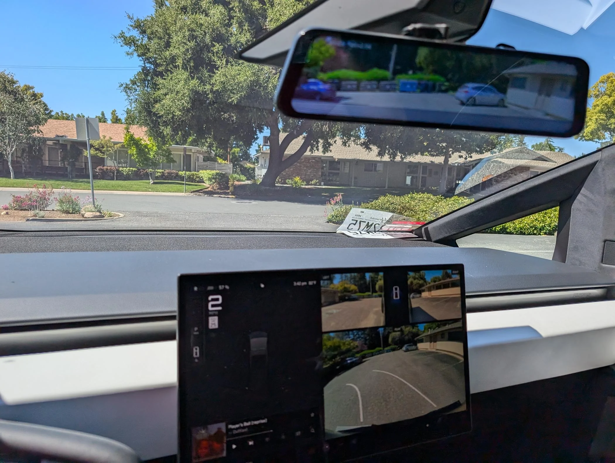

I envision a small screen up above and a simple push and hold of the rear image on the center screen then a "clone to upper screen" option.
Anyone else wish that when you signal to change lanes or at a stop that both side and rear view stay on the screen. I would to know if someone directly behind me is coming in hot to potentially avoid a situation.

I drove my other vehicle with a rear view mirror. The image in an actual mirror allows me to make out vehicle makes a lot better. I think it's a zoom problem, or maybe the mirror image needs to be 50% larger.
There's been a few times I was driving and wondered "is that a police vehicle behind me?" It was not possible to tell if it was the police or a personal vehicle that looked like a police car. That's never happened when I used a real mirror.

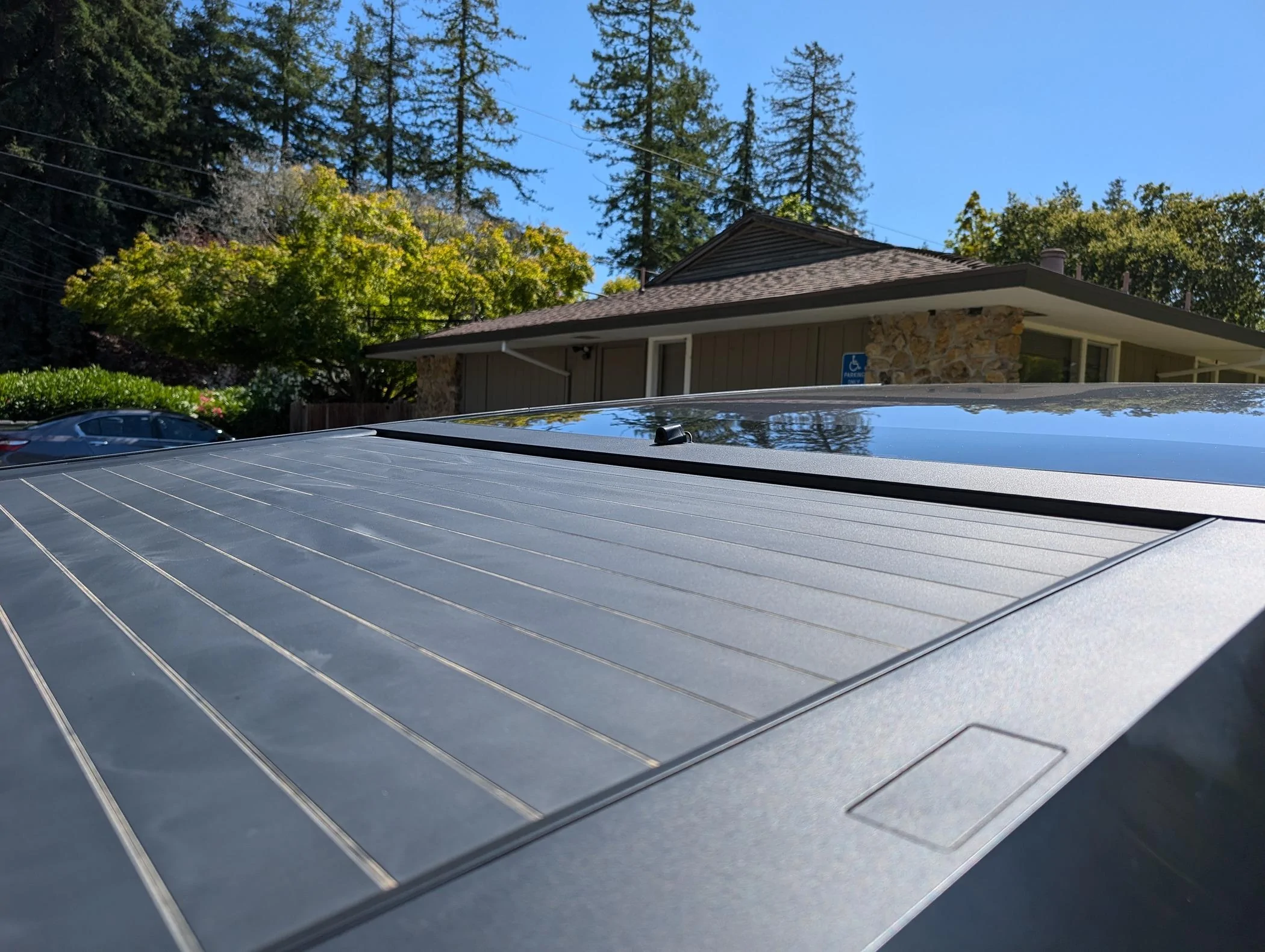

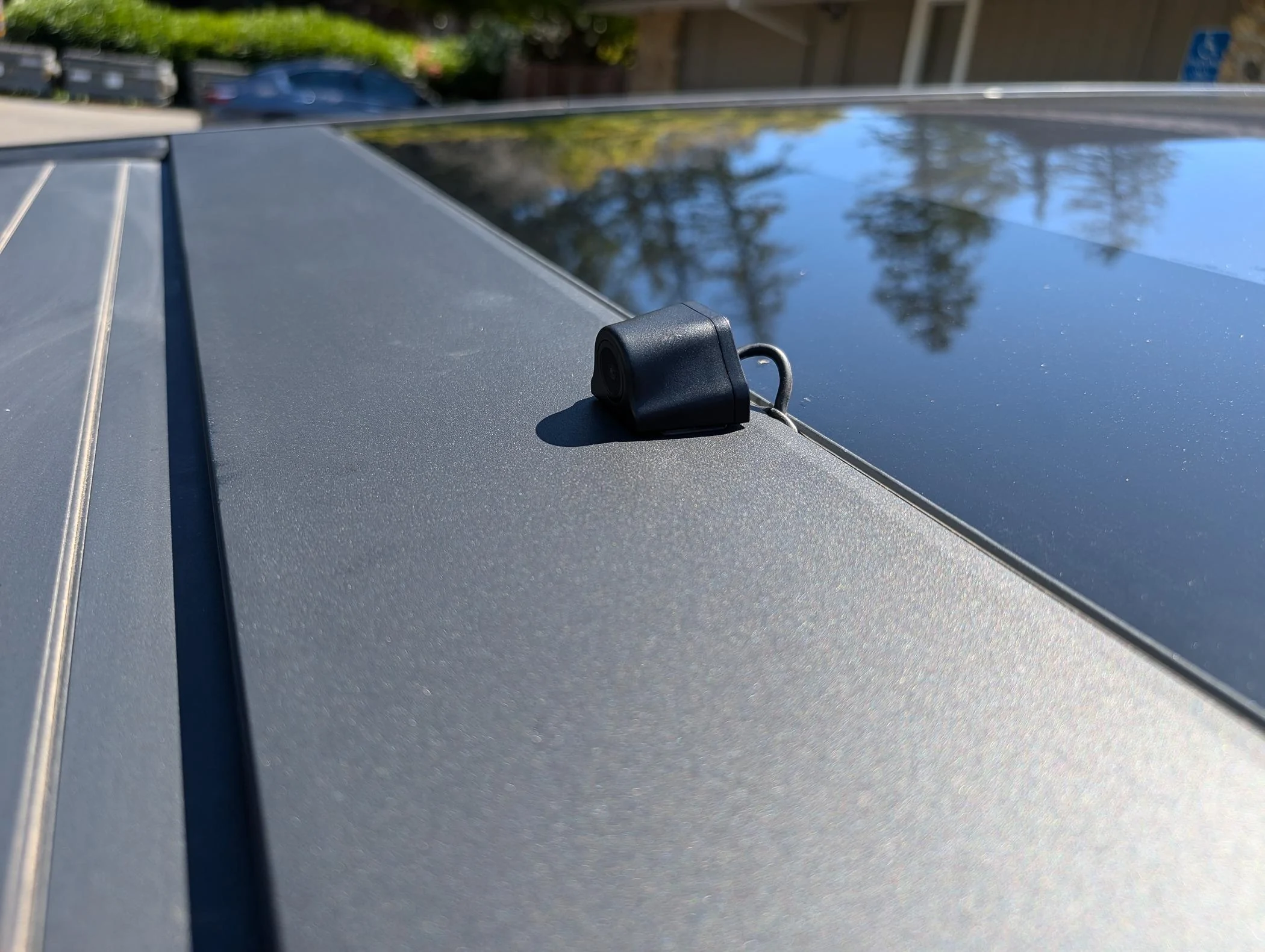

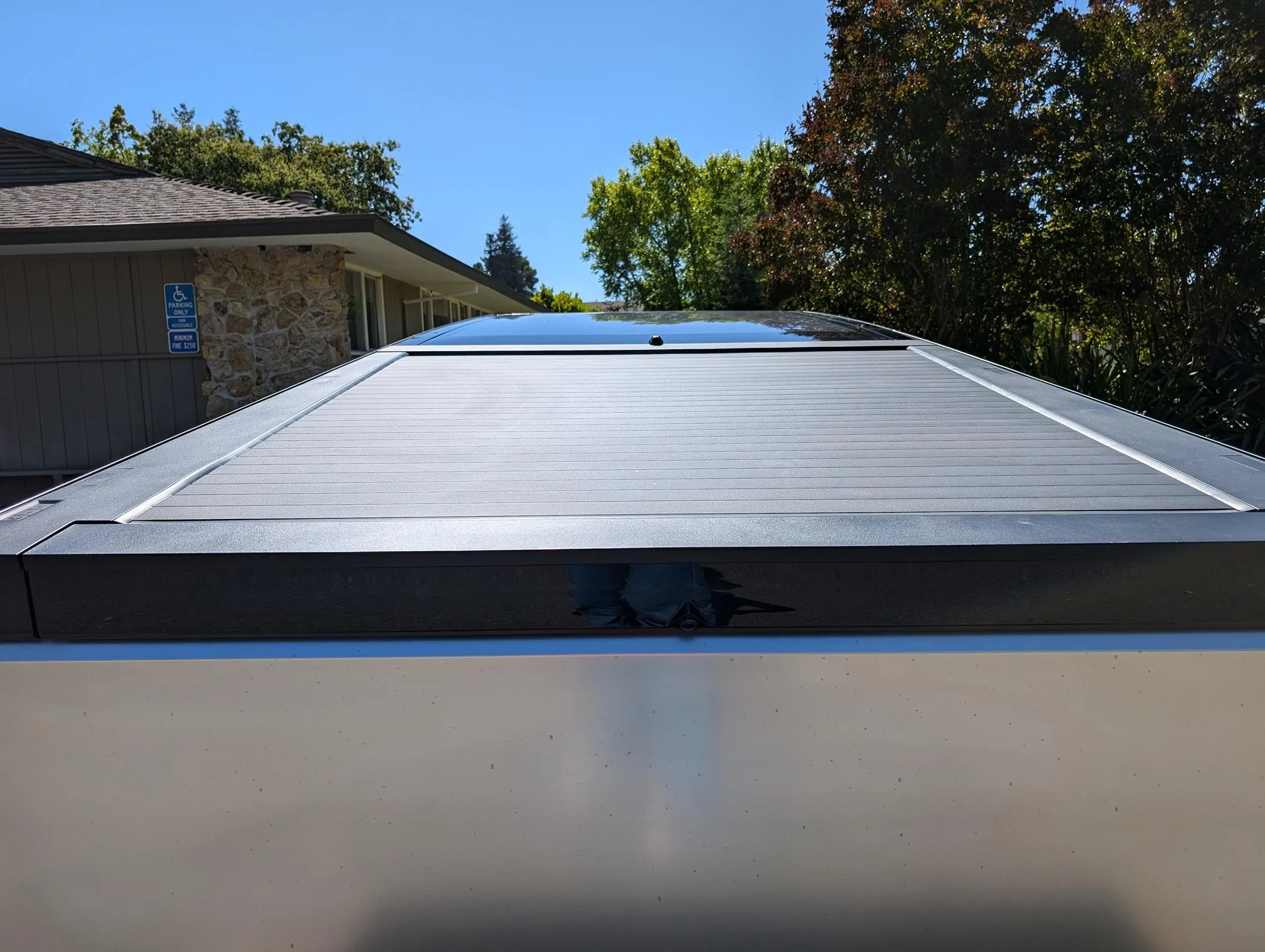

Mounted the camera higher and the view is very helpful. This view is ideal for seeing motorcycles splitting lanes (California) and seeing them better now to safely move over to give them more room. This rear view camera/display functionality should be from factory. My Corvette has it on the mid to higher specs. I spent a lot of time hiding all the wiring. I used a 90 degree USB-C and double stick 3M tape to mount the 12V adapter to Type-C adapter to the rear console right Type-C port. The only issue is that the USB port stays powered, so I need to remember to turn off/on the display. A future issue might be that the in-cabin camera might be partially obstructed by the display location. We shall see.
Tesla Roadster 2nd gen Digital Rear View Mirror Installed - WOLFBOX 12" Rear View Mirror Camera ... cheap and it works PXL_20240615_224232033
Tesla Roadster 2nd gen Digital Rear View Mirror Installed - WOLFBOX 12" Rear View Mirror Camera ... cheap and it works PXL_20240615_224147864
Tesla Roadster 2nd gen Digital Rear View Mirror Installed - WOLFBOX 12" Rear View Mirror Camera ... cheap and it works PXL_20240615_224128079
Tesla Roadster 2nd gen Digital Rear View Mirror Installed - WOLFBOX 12" Rear View Mirror Camera ... cheap and it works PXL_20240615_224123212
Tesla Roadster 2nd gen Digital Rear View Mirror Installed - WOLFBOX 12" Rear View Mirror Camera ... cheap and it works PXL_20240615_224119681
Mounted the camera higher and the view is very helpful. This view is ideal for seeing motorcycles splitting lanes (California) and ...
Yeah, that's good thinking! You really need a narrower field to get that 'zoom' people were talking about... The wide field in the Tesla camera is great for backing up in a parking lot, but less great for checking your blindspot at speed.
how did u hude the wire ? i done the same thing but u can see the wire going across the back of the truck and into the Rear pass Door .
