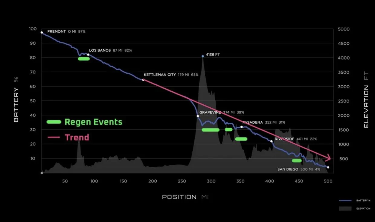

thanks, looks cool. I can't tell from the data your showing, but exactly what difference did the brake regen have on the outcome?
Tesla Roadster 2nd gen Towing Range Numbers? IMG_2697
This shows SoC over distance, with the elevation changes overlaid. The green bars show how the SoC recovered when traveling downhill.

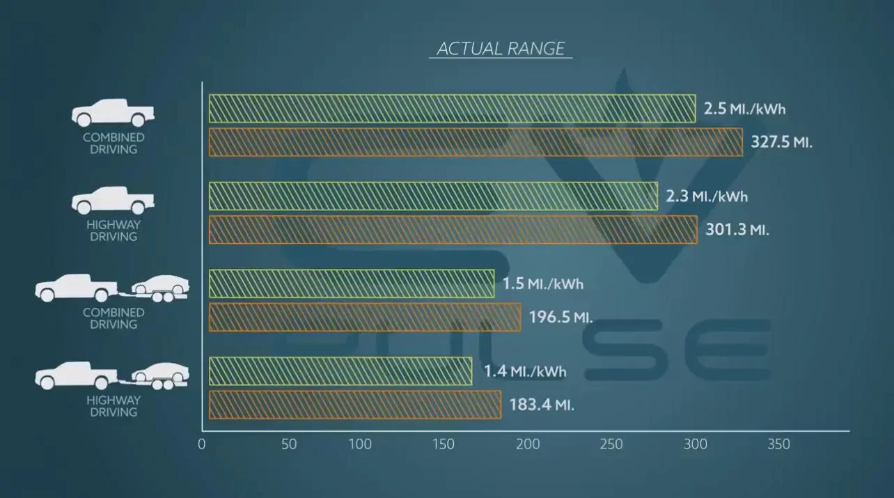

On the other end of the aero/weight equation, here’s (actually detail-oriented) EV-Pulse guys with a car hauler with a Model Y (7K lb), who did both blended city/hwy and full hwy tests, with and without the trailer, and these are their results:
Tesla Roadster 2nd gen Towing Range Numbers? C292ED35-22BF-4D0F-9834-3D13B3D26E64
That above 1.4mi/kWh / 183mi for their full highway towing test, results in a CT assumed equivalent of 172mi

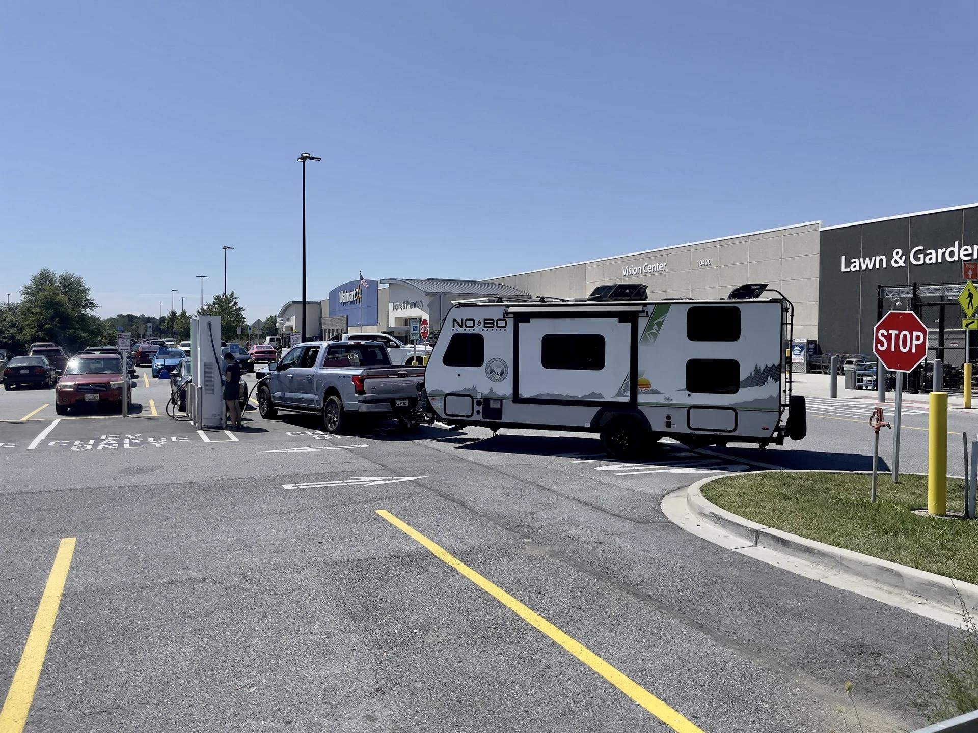

Then to scratch your camper-like scenario itch, here’s a guy with a 20’ No Boundaries (10’ tall and 8’ wide) (3700lb):
Tesla Roadster 2nd gen Towing Range Numbers? 00373D33-CDB8-4E8A-9C3E-09B31E24F27C
His was a major hilly route into the mountains, at while at an average of 55mph (more in that later), he averaged 1.22mi/kWh (from 1.3 on flats to 1.0 in major hills) in his ~1700' elevation change out trip, resulting in a CT assumed equivalent of 150mi
On his return trim (hills working for him), he averaged 1.34 mi/kWh, resulting in a CT assumed equivalence of 164mi
He later does a 280mi trip at 65mph, and gets 1mi/kWh or CT 123mi equiv

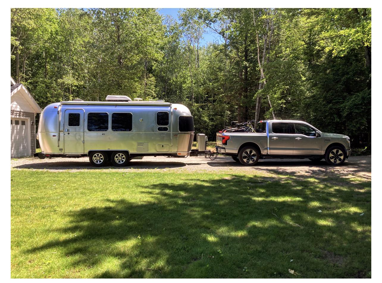

Similarly, here’s a guy with an good sized airstream, did his first ever trip (hadn’t yet even learned the tricks), did all speed limits, and got 1mi/kWh uphill in a headwind to destination and 1.4mi downhill no wind from
Tesla Roadster 2nd gen Towing Range Numbers? BABE9221-5821-4A45-BA04-2B910D2C4FA3
again, pulling a damn airstream (not as aerodynamic as people think) that’s a CT assume equivalence of 123mi uphill/headwind and 172mi downhill
Ok, so we’ve covered “people think are aerodynamic but aren’t” (the boat), “aerodynamic but heavy” (the car hauler with a Tesla on it), two reasonably large campers/RVs, which is a pretty good range of what (I think) anyone should expect to be doing with a 1/2 ton truck rated at 10K towing. And, these are reports from people who understand the truck and BEV truck towing, and even one guy who did his first tow With the airstream. And these again aren’t meant to be exceptions to the rule, but instead indicative of the rule observed when looking not at Y/T but instead real owners who have any clue what they’re doing.

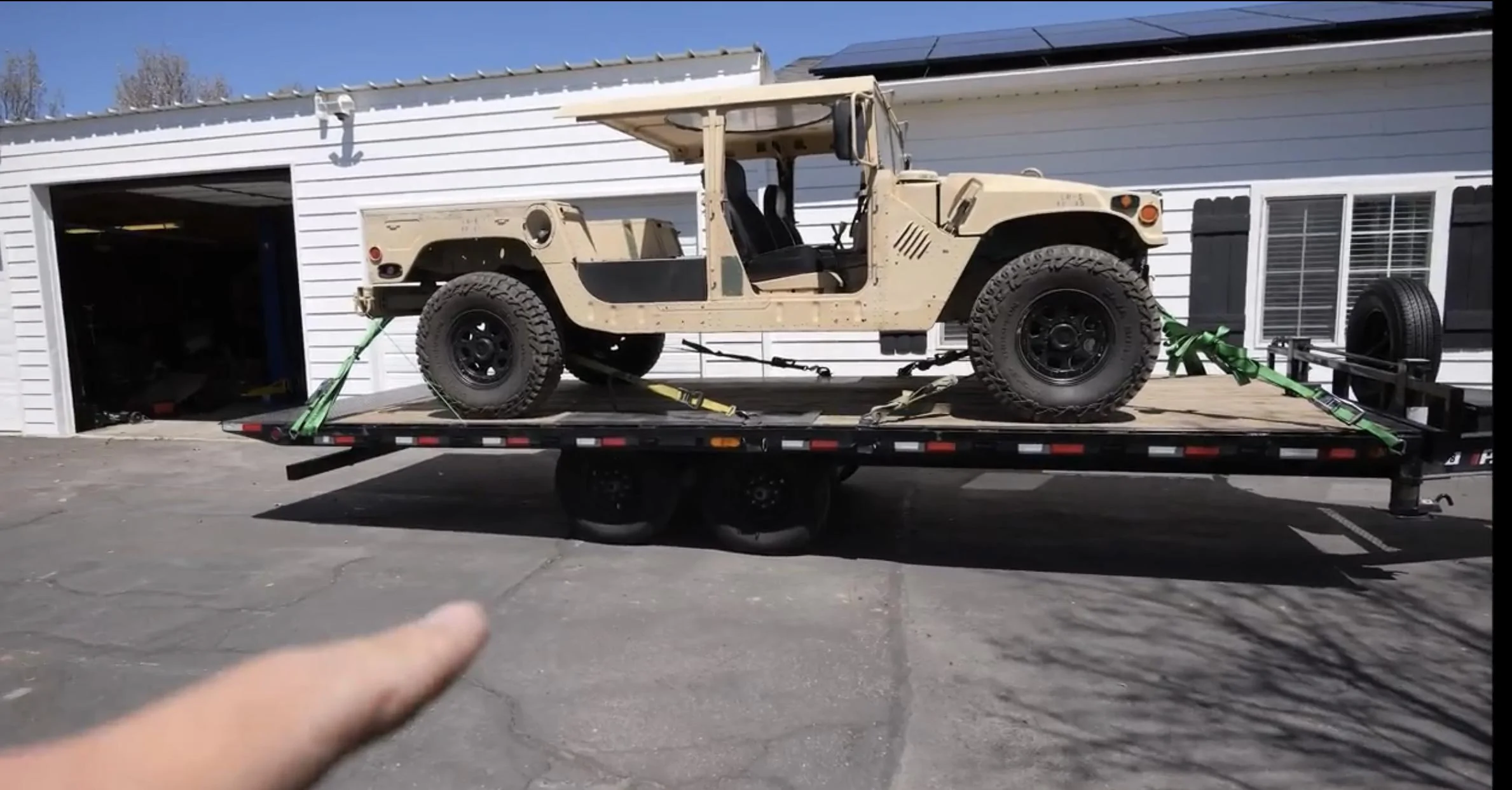

Here’s a Y/T towing 10,000lbs (really more than you want to do with any 1/2 ton truck), and while it’s a car hauler, it’s hauling in this case a f’n HumVee
