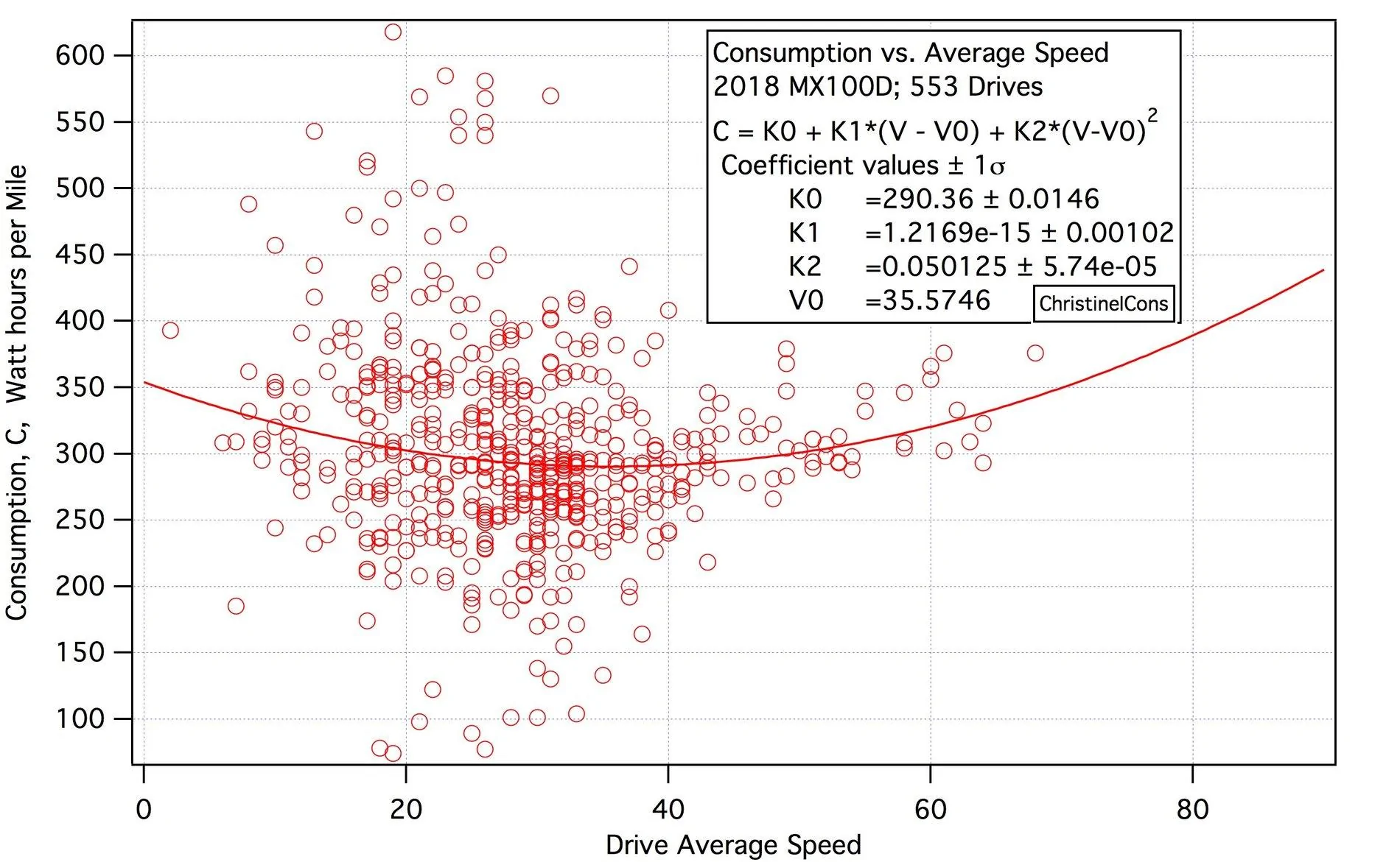

That's why my Chevrolet Bolt can get over 370 miles running around town but only 190 on the freeway.
It can't be that bad! If it is it's because the car has the drag coefficient and frontal area of the Titanic. Inertial load is linear with mass and velocity, Drag load goes as the cube of velocity (but does not depend on mass). Thus at higher speed eventually you come to the point where drag overcomes inertial and other losses and becomes dominant. That's shown in the following consumption data extracted from a years worth of drives in my X100D
Tesla Roadster 2nd gen Towing Range Expectations ChristineICons
You can clearly see the loss of efficiency at lower speeds and. above 35 mph, the drag starting to creep in. The fit shows the coefficient for the squared velocity term which is proportional to drag to be about 0.05. Putting in your numbers and making an assumption that your Wh/mi are about 200 at 35 mpH says that your drag is 3 times that of the X and that just doesn't make sense. So something wrong with your observations and hence your conclusion.
Electrics are efficient in town, and you can thank regen for that.
Yes they are but they are also efficient on the highway, My data shows it. Overall I got 301 Wh/mi with that X city, country, freeway, dirt road...
Without regen a petrol powered vehicle is better at distance.
When one says something is better he must tell us what his criterion for goodness is so you'll have to be more specific here. But clearly in terms of energy used per mile traveled ICE and diesel vehicles are far inferior to BEVs. Even with gas being as cheap as it is at he moment they aren't better in terms of cost. They aren't better in terms of maintenance, or emissions or anything else I can think of except the time it take to top them off.

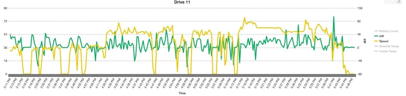

Now, I do know how much I change speed on the freeway. I know from experience what my Bolt EV is capable of and when there's a head wind or tail wind that is influencing it. So, let's take the average of 190 miles on the interstate for Kansas, Oklahoma and Missouri. That is over 100 trips. The EPA rating is 238 miles. 190/238=.798 or 79.8%. So 20.2% range compared to the EPA estimate. Now let's add RJ Scaringers estimate of 30+% (see attached)... See my point? Now both the Rivian and Cybertruck aren't out and all we have is the what Tesla thinks the EPA estimate will be. We can do rough estimates for the Cybertrucks interstate range, but again it's an estimate. IMO you'll see 200-260 miles in the tri motor traveling on the interstate.
You are making the common mistake of assuming that because you obtain 80% efficiency on the freeway that everyone does. I obtain 98 - 100% on hilly freeway and 104% overall (in my old X). But I don't presume to tell anyone that he will get 104% of 500 miles in his new EPA 500 miles rated CT based on my experience. In advising people what to expect I turn to the fleet statistics. The picture below shows the attained efficiency of the portion of the Tesla Fleet that subscribes to Stats:
Tesla Roadster 2nd gen Towing Range Expectations IMG_1299
As you can see the mode is about 85% and the average is probably close to that as around 84% is the average for winter time but we are climbing out of that and headed for the 96% average Tesla drivers experience in the warmer months. Note that the 107% figure is for my new X which only has 380 miles on it at this point.
Tesla Roadster 2nd gen Towing Range Expectations IMG_1296
Thus if I were to predict range for the CT I'd say it's going to be about 450 miles in summer and 420 miles in winter for the average driver but point out that half will do worse than that and half better ane that each will experience appreciably above and below his average. 200 - 250 miles would represent, in a 500 EPA mile vehicle, efficiencies of less than 50% and is clear from the histogram that only 1 or 2 percent of drivers will do that poorly.
Now when you add a trailer, of course, the picture changes. In the low speed regime it is the inertial and gravitational loads that dominate even with regen and so adding a trailer that weighs as much as the truck will cut the range about in half. Try to pull that same trailer at 70 or 80 mph and drag becomes a major player with range reduced to well below 50%.
