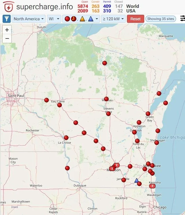

I could hit Stevens Point and Wausau but that's just another 40-50 miles out of the way. A perfect spot would be in Antigo. A lot of vacation people head up Hwy 45 to Eagle River. I'm sure it will happen sooner or later.Have you checked PlugShare for CCS options?
I don't see any permits in non-populous areas yet. That crowd-sourced site is good to watch.

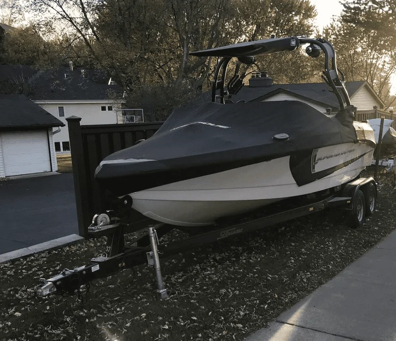

Boats on trailers are surprisingly not as aerodynamic as one would think. They sit up high. They are wide. They have a frontal area as big as the truck. Plus lots of things sticking up like windshields, seats, motors, wake tower, bimini, trolling shields. Then they are squared off at the back creating low pressure drag. The trailers themselves have lots of cross members, axles, spare tires, lights and license plate hanging down, and big fenders that stick out wider than the truck. The shape of the boat pushes more air underneath the trailer. Sometimes tarps are loose and flap or inflate like a big parachute and turn into a drag increase instead of making the shape smoother.So, what you're saying is that I can't make it 200 miles towing a fiberglass walleye boat that weighs about 4,500lbs driving 60mph.

60 amp on plugshare there -- eat lunch type stop for a little boostI could hit Stevens Point and Wausau but that's just another 40-50 miles out of the way. A perfect spot would be in Antigo. A lot of vacation people head up Hwy 45 to Eagle River. I'm sure it will happen sooner or later.
