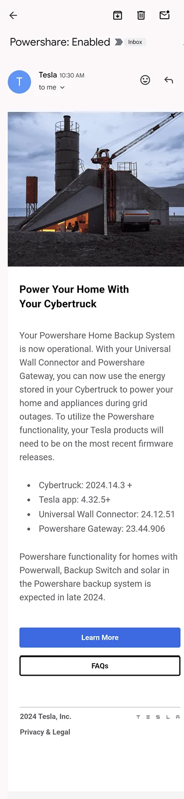

Just got an email from Tesla starting Powershare has been enabled. I've not had a chance to test yet.

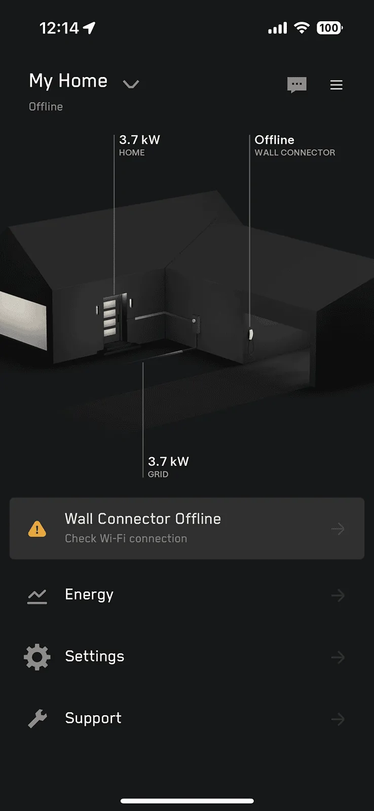

I received the same email today, but I'm not seeing it as activated in my app and am curious if it's just my install or if you're seeing the same thing. If I go to My Home in the Tesla app, it shows my Wall Connector is offline, but it does show up under my Tesla Electric view as being online.

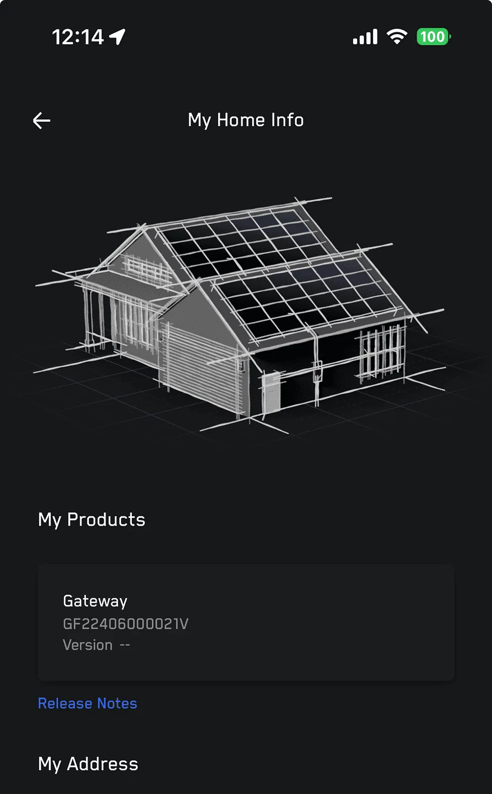

Also, if I look at the Gateway for what version it is running, it shows no value for the firmware version.

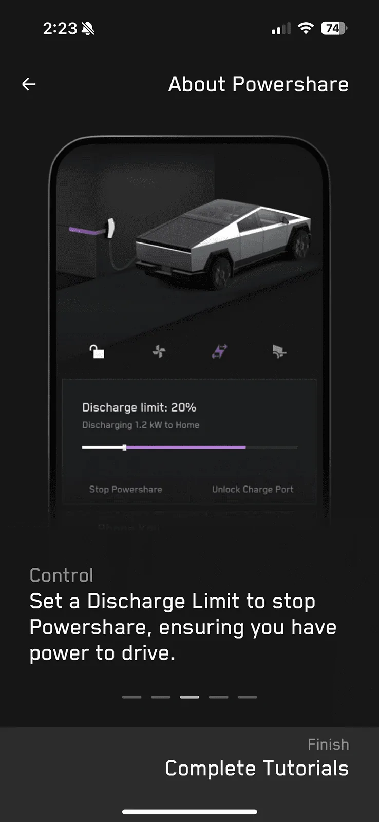

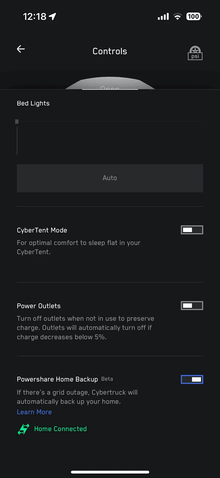

I do see the option on my truck to enable Powershare and it is turned on, but I don't see the ability (as shown in Tesla's screenshots) to limit how much of the battery can be consumed before Powershare cuts off.
Tesla Roadster 2nd gen Powershare is Activated / Enabled 1715275396476-gg
Something seems wrong to me, but when I reached out to Tesla about it yesterday they told me the software wasn't coming until June. I'm not sure if they're misinformed or if what I'm seeing is expected at this time. :/
I had the same issue with the wall connector at first. It reported having WiFi issues though it was connected to WiFi. I had to open a ticket to get that sorted.
The powershare page in my app looks the same as yours. I'm not at home so can't test yet.

Cool. I'm on with Tesla support right now and trying to work through why my Wall Connector is showing offline when it really doesn't seem to be.
