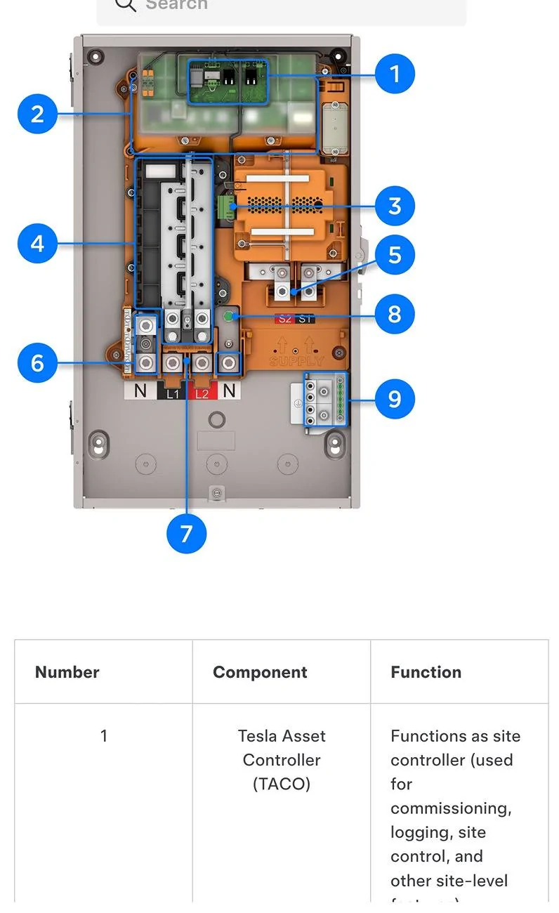

Powershare uses Gateway 3V, V for vehicle (probably). It is a Gateway 3 + neutral forming transformer + site controller.
I believe the installer can disable the site controller/ TACO to allow the Powerwall to serve that function (which is the normal Powerwall setup). No need to pull parts from another Gateway.
Note that while Powershare recently started working with solar, it still doesn't work with Powerwall, yet. But when it does, it should work like you mention.
Gateway 3V
https://energylibrary.tesla.com/doc...UID-BB39FEDC-C4D3-4AB1-9858-96C82563FADD.html
Tesla Roadster 2nd gen Powershare update: Home Backup enabled for Solar + Backup Switch SmartSelect_20250330_074947_Firefox

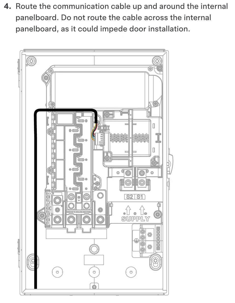

Gateway 3:
https://energylibrary.tesla.com/doc...UID-C2CF965B-EE68-42E6-BAFD-166E72C5B967.html
Tesla Roadster 2nd gen Powershare update: Home Backup enabled for Solar + Backup Switch SmartSelect_20250330_074858_Firefox

I have no idea what that last sentence means. But I have 2 gateways too many! I need to get rid of them both.
You need A Gateway.
For Powerwall, you need Gateway 3 (or Backup Switch, but you said installer was using a Gateway) connected to the Powerwall(s).
For Powershare only, you would need Gateway 3V connected to the UWC.
Do not attempt to run communication wiring between the Wall Connector and the Powerwall or Backup Gateway.”
In no case is a communication cable run from UWC to Powerwall nor Gateway 3. (Only a GW 3V in a non-Powerwall Powershare system).
