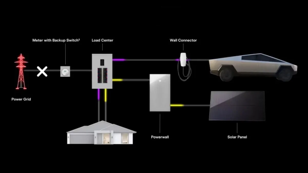

Yeah, that was just stock wording because solar and Powershare don't (didn't?) play nice, yet.
The Powerwall setup and solar sit behind the Backup Switch on your solar (bidirectional?) meter.
The Powershare Gateway looks to be fed off the main meter. They might have gone grid-meter-gateway-existing_setup, but based on your energy screenshots, Powershare lives on it's own.
Those images are both current? The truck shows up in both views simultaneously?
AFAIK, they installed Powershare upstream of the original Tesla Energy system. The OWC does not show up on the original Tesla Energy page in the app; it *does* show up on the Powershare page.
Powerwalls installed July 2023; Powershare June 2024. The truck shows up in Powershare but no longer in the main view. It used to, before Powershare. I was under the assumption that a software/firmware OTA update would resolve these issues; perhaps I am being premature. The 3rd party Powershare installer mentioned asking Tesla to make the Powershare Gateway the master and the Powerwall Gateway the slave.
Tesla has escalated my Charge-on-Solar issue. Just a moment ago, they sent me an email asking if I was still having trouble. I haven't been able to test it, again.

Ok, so the Crib picture is how it used to be and the Powershare is how it is now?
What was the original charge connector?
There isn't a way to link Gateways (and you only have the one + Backup Switch, right)?
If you did have two Gateways, you could theoretically stack Powershare after Powerwall, but that's not really useful.
The UWC needs to move to the backed up side of your Powerwall system (where the original EVSE was) and get added to the location. The Powershare Gateway isn't needed.

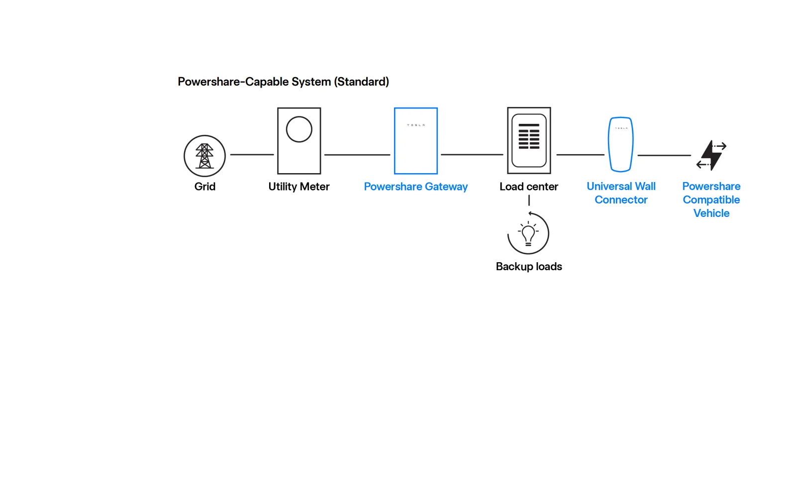

This is more representative of my Powershare installation:

In that case, if Charge on Solar still isn't working with the updated location, one could have the installers disconnect the communication cable from the UWC to the Powershare Gateway and possibly the comm wires to the isolation switch, delete the Powershare group, and add the UWC to the crib group. That would put everything under the Powerwall group and prevent the Powershare Gateway from disconnecting.
Note, Powershare will not feed the house until after the new software is released.
