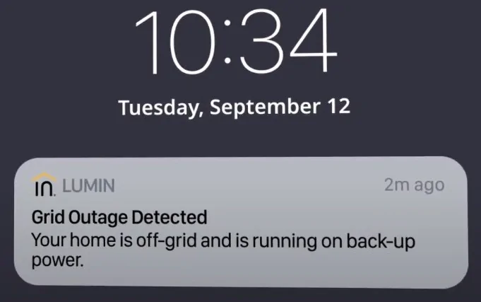

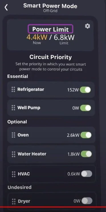

I’d use that spare $2k to install a Span Panel as your main panel, would slide to to shed loads from your phone or even automate the load-shedding through the Span panel
I plan on using the Lumin Edge where you can add them to whatever circuits you want to control.
https://www.luminsmart.com/lumin-edge
Tesla Roadster 2nd gen Powershare Full Panel Backup 5lb41jK
Detect outage and limit power:
Tesla Roadster 2nd gen Powershare Full Panel Backup QIu4hRE
Tesla Roadster 2nd gen Powershare Full Panel Backup j87tLSB
