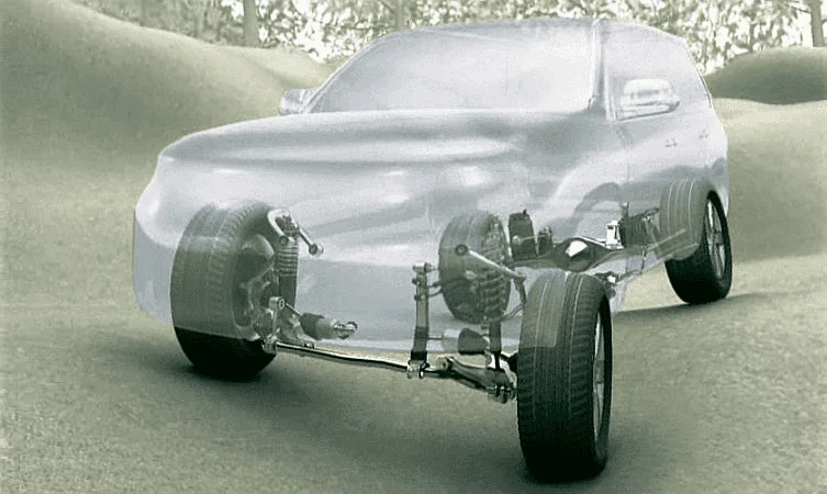

I hope that's true that it can be cross linked, and I'm grateful for the lockers being there in hardware, as it was mechanically obvious something had to be done there to give it some capability.
But, I honestly believe that they have dropped the ball here, in that the front and rear stabilisers don't have a disconnect. You can't "program" a disconnect so the problem will primarily remain until the hardware is changed and retrofitted. Thats not a good look, either way.
To me this means that Cybertruck testing and the engineers involved in its offroad capability, never got as far as addressing this head on, and have simply installed sway bars like any other road going Tesla and tuned it for good onroad handling. This might of been due to various factors, but likely because of the lack of experience in terrain modeling and its dynamics on suspension components. This is the reverse process of designing to constraints, or by first principles for that matter, if by their own accord, they simply designed the hardware that is installed on a customer vehicle, without even testing it to full suspension travel, as will always be the case when a customer takes it offroad.
Every bit of suspension lift created by the sway bar and air bags is reducing overall traction. Using the lockers, or traction control to compensate for it is the worst way to fix it, and brings about a whole host of other drivetrain issues and lack of steering capability which in turn is crucial in those situations.
Simply the current suspension design is reducing traction and vehicle stability, and usinh countermeasures to compensate for those failures, is poor form to say the least.
In saying that I admit however, that a mechanical sway bar disconnect is a simple affair to retrofit, but that only highlights the omission of one in the first place even more.
A simple suspension test mule would have highlighted these problems on any company off-road test track or simulator stand. They had 4 years to solve this, and how to enable diff locks without wrecking something as well.
Ideally they'd install a Kinetic/KDSS type setup, as this is idiot proof and needs no driver interaction, and could be installed by simply replacing one of the linkages at the end of each front and rear sway bar, and running two hydraulic hoses between the actuators. Thats probably the best passive system, but active ones are also possible but would likely cost more.
