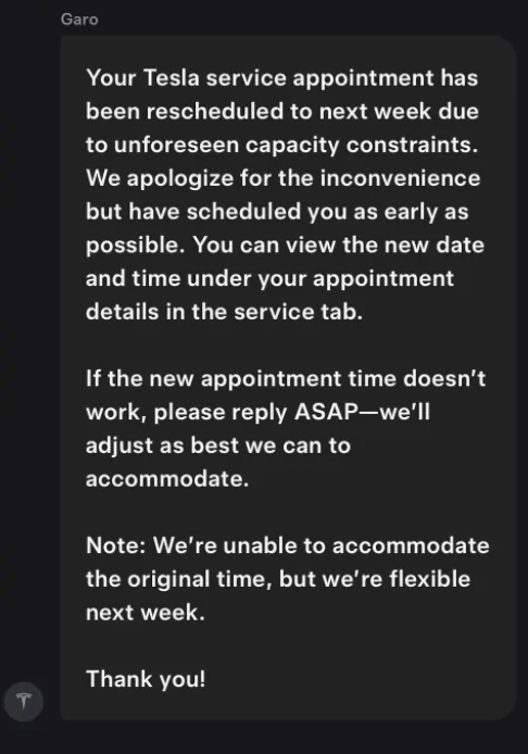

Was going to get it reattached on 4/11 (along with tire rotation, camera cleaning, etc) but they just randomly rescheduled it? It's on the 15th now, lightbar reattachment is free.

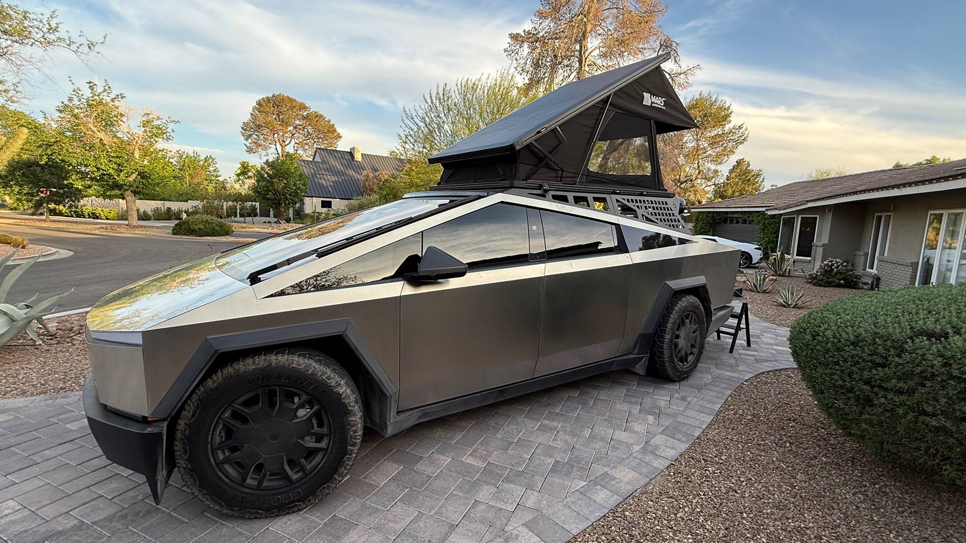

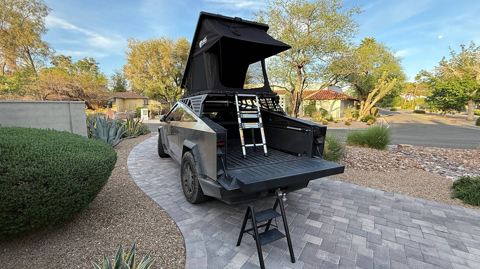

Well sir, you turned out to be exactly right!!! Look what showed up today I’ll have a lot to say over the weekend barely got it on and home but I’m about to be one happy camper!!!!

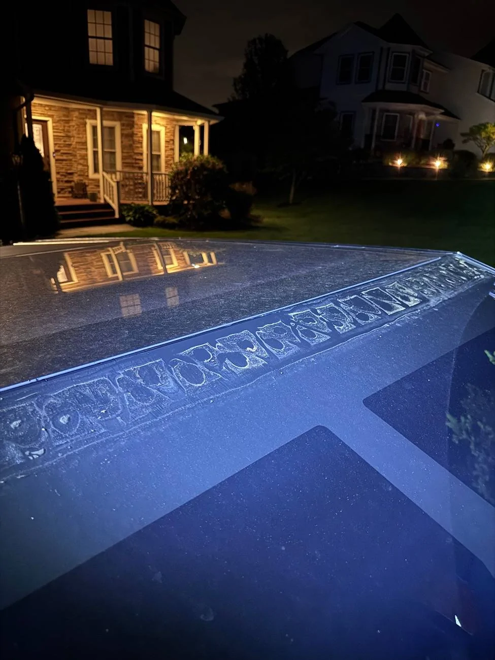

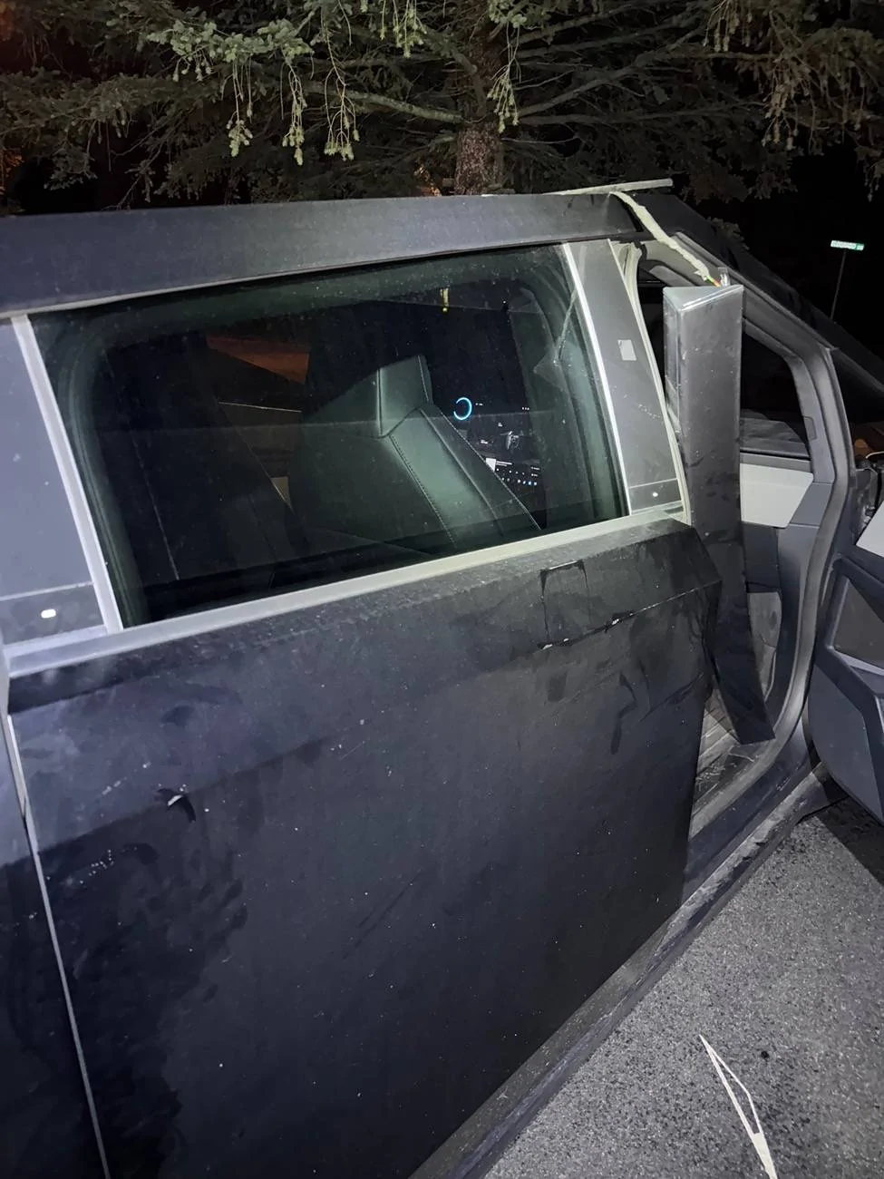

I was cautiously confident that this would never happen to me but lo and behold my light bar came off while driving last night. I was driving about 40 mph but was lucky to be around the corner from my house so was able to get home quickly. Unfortunately my truck is wrapped and when the bar came off and was dangling it gouged my wrapped in several places. Not sure if I will get any pushback to have them pay for the damages there. We shall see. All of the adhesive remains on the light bar with zero residual remaining on windshield.

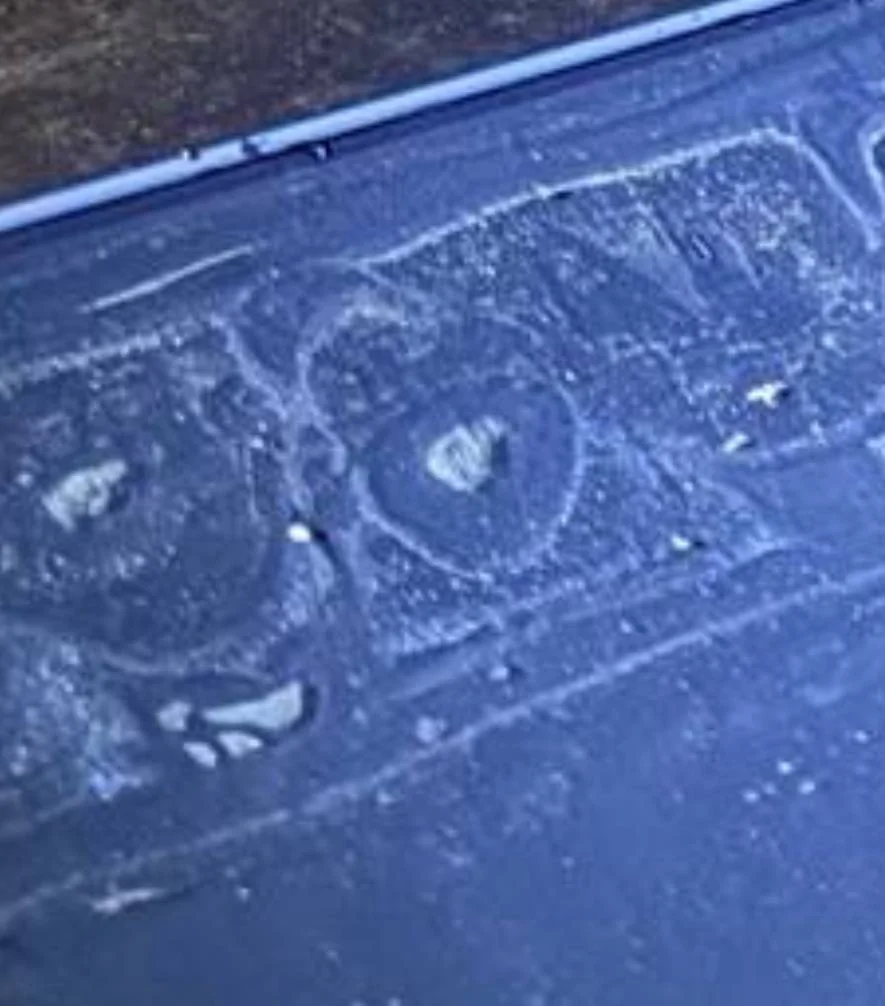

This is just dirt, not adhesive?
The specified adhesive is made for attaching windshields to cars, so lack of residue points to poor surface prep.
Yes, that is mostly dirt. Here is a better pic of backside of light so you can see where the adhesive lies.
