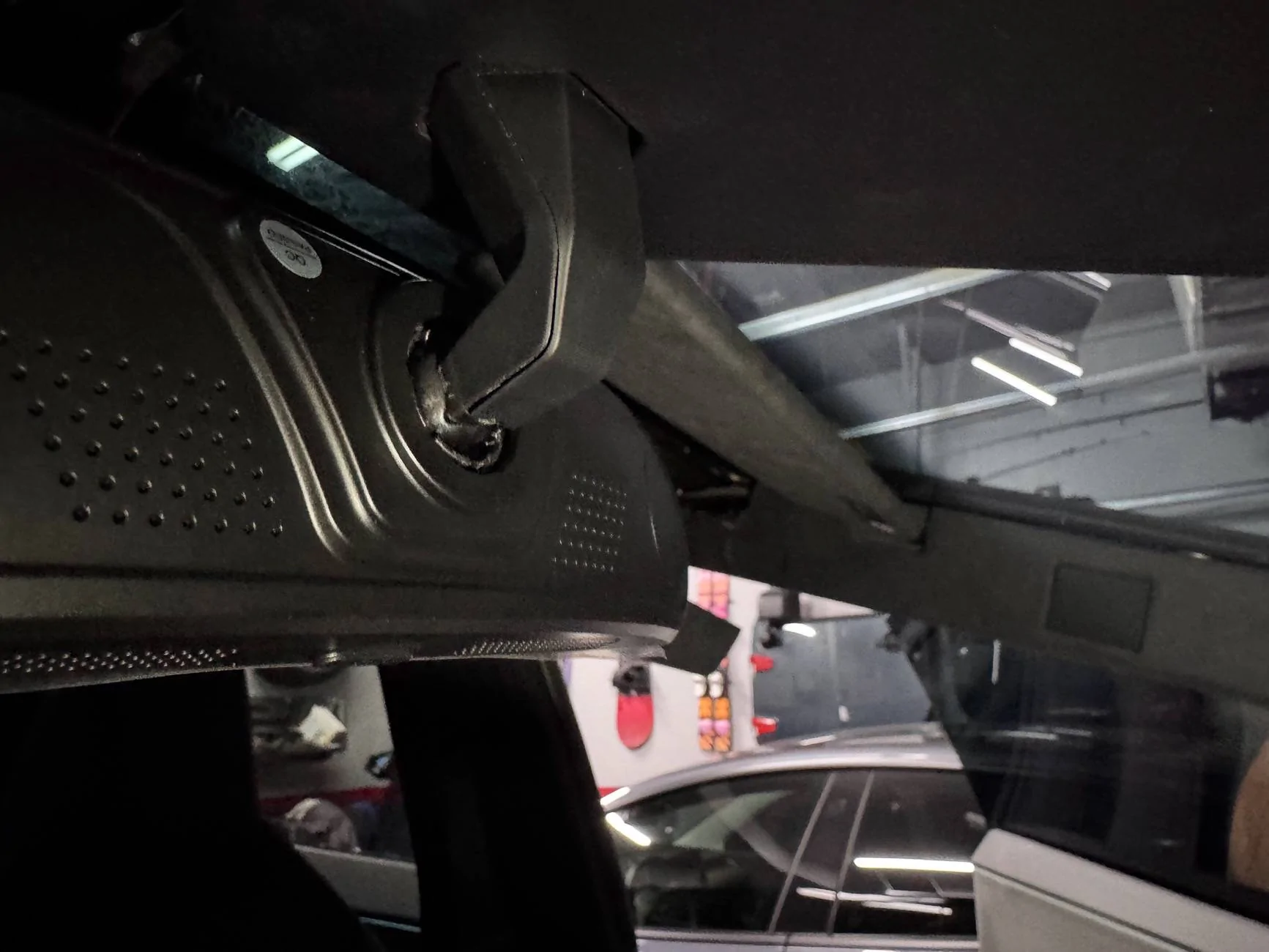

In case you were wondering what the rear-view mirror is like in the winter vs the standard tailgate camera, here is your video:
Tesla Cybertruck Hansshow V2 (2.5 / 3) Upgraded Media Rearview Mirror Install Article and Video 20260124_135505
Tesla Cybertruck Hansshow V2 (2.5 / 3) Upgraded Media Rearview Mirror Install Article and Video 20260124_135510
