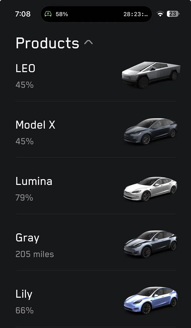

Same. I have this many:
Tesla Roadster 2nd gen FSD on CT doesn't work when you have a 2nd Tesla with Autopilot enabled IMG_2249
I have no idea what they’re talking about. ??‍♂ Each one of these cars is on FSD each one of them have their own installation three of them are on HW4 and two are on HW3 and they’re all on various branches of FSD.
How would my profile have any effect on how these cars ran auto pilot or FSD? It doesn’t run from the phone! I have one profile that runs on all of these cars - without issue.
Which is the point of having a profile! The seat settings in my Cybertruck don’t affect the seat settings in my S Plaid or our X etc
Correlation is not causation. What are you people talking about???!!!!
Edit: just digesting this. are you saying that because your cyber truck doesn’t have regular auto pilot and you have that profile selected in your other car that it confuses the Cybertruck? [of course you are that’s quite literally what you said] I still don’t understand why that would happen.
But, I will never find out because I certainly didn’t pay for FSD 5 times over to only use auto pilot. ??‍♂

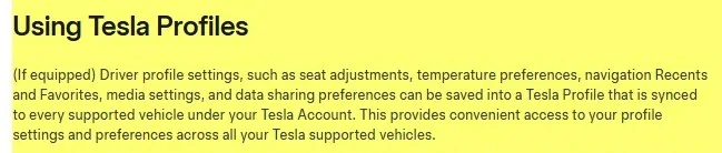

From a TM3 manual (but same in other Tesla manuals including the CTs):
