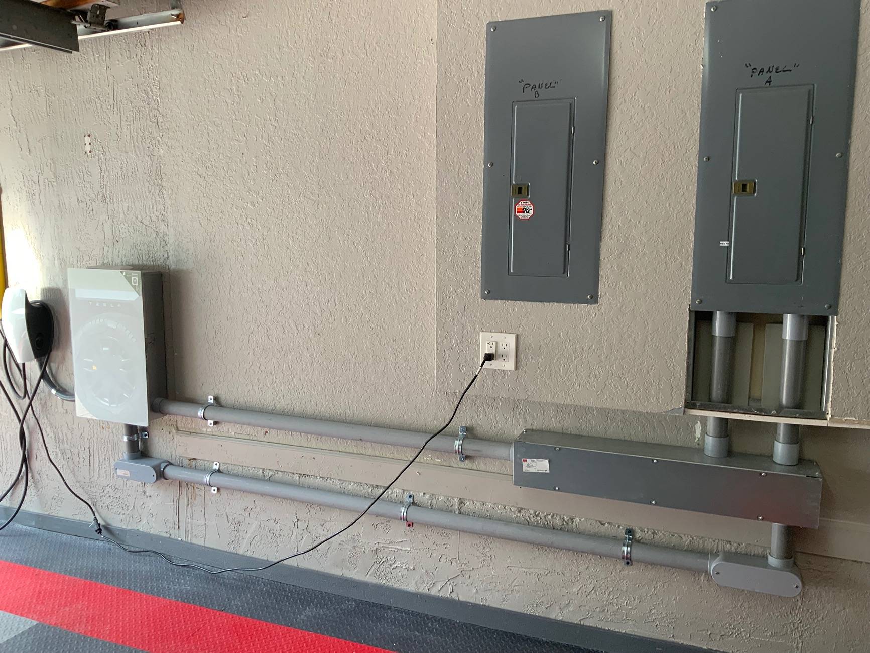

Well,it was a long wait (7 months) and after many frustrating cancellations got the system installed. Local FPL inspector came out and approved. Hurricane season is far away but glad to have it. With 4k installation credit and 2.5k towards the gateway/charger, I am out of pocket 1,600$. Well worth the price in my opinion.

The installer on behalf of Qmerit had a tablet in which he scanned a bar code on the gate way. This downloaded software directly from tesla. Under products-Powershare on my app allowd me to download the operational display of the system. The Installer sent info to Qmerit after the inspection. Did not contact Tesla. If your installer is Tesla certified and thru Qmerit I believe it is good to go.
