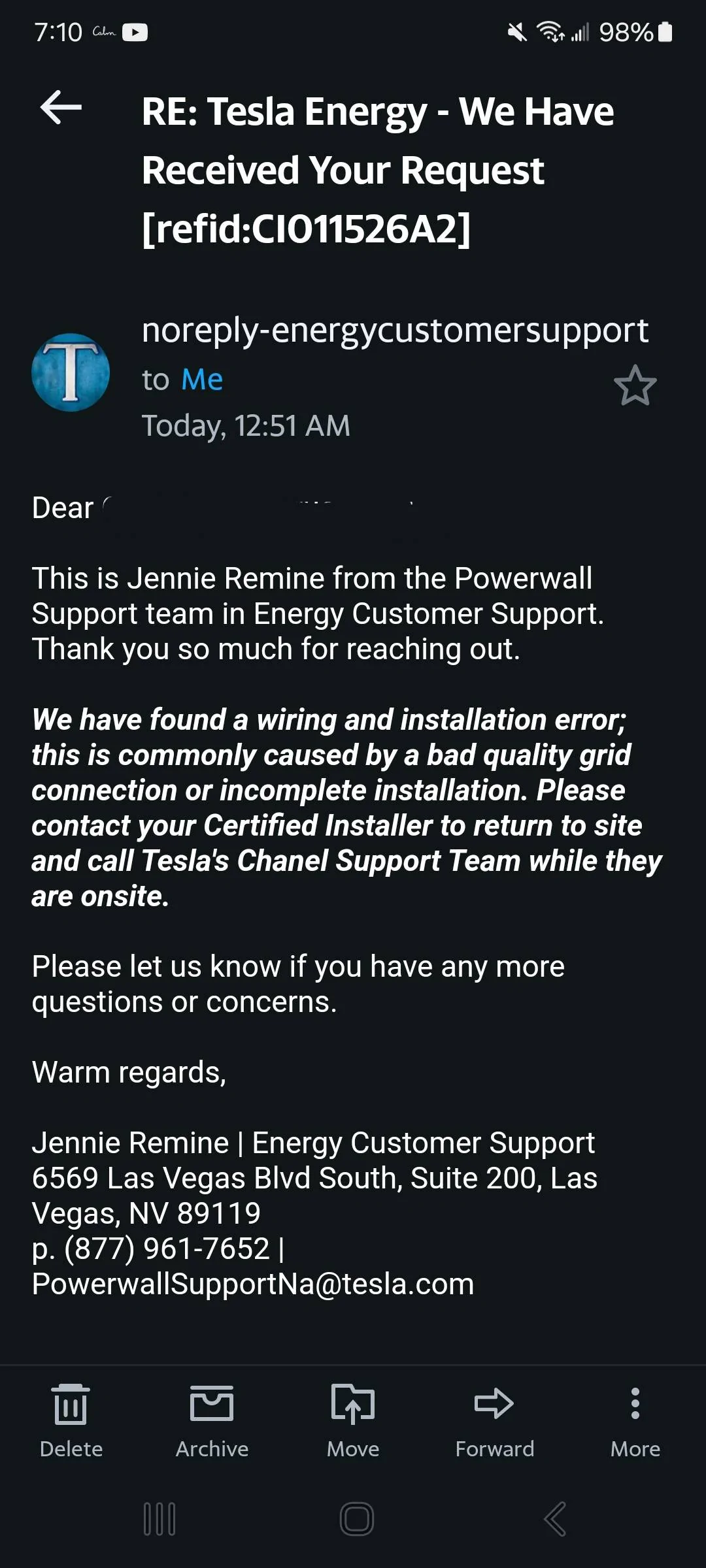

I've had Poweshare fully installed for over 4 months (since early May) in SoCal. I also have Solar. The electric charger works to charge my vehicle, but has Never worked to power my home during a simulated outage. Installer said tesla was working on an update to roll out in June. Emails to [email protected] have gone unanswered - until now.
Here is what they said...
Tesla Roadster 2nd gen Powershare Team Response - FINALLY Screenshot_20240909_071038_Yahoo Mail
Anyone else get this response... seems very vague and frustrating after 4 months to get this response.

I've seen evidence of people with Powershare working! But I am not sure if it's related to having solar also.
Freaking annoying the conflicting messages. Is it an install problem, or a software problem - no data other than "We have found a wiring and installation error; this is commonly caused by a bad quality grid connection or incomplete installation. Please contact your Certified Installer to return to site and call Tesla's Chanel Support Team while they are onsite. "
Installer thinks it's software, but.... that's not what Tesla is saying.
