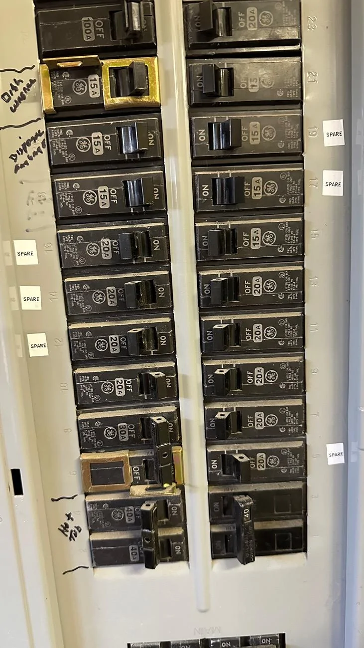

Agree Connector only needs one due to use of high voltage insulation on communication wires.
Regarding panel connections, NEC does not allow fused and unfused (service) conductors in the same conduit, so if that were a full panel backup (which it isn't), it would require two.
Gateway knockouts are 3/4, so they likely went that size versus drilling out the case and dealing with bending larger conduit.
However, that would be a little sus since 3/4 EMT only holds two #4 THHN, so did they run 6 AWG? If so, the UWC charging along with (up to) 48A of loads would overload the circuit...
@Ironalley, would you mind sharing photos of the main panel and Gateway breakers?
Side note: that Tesla image has three conduits leaving the Gateway. Third controls the backup switch.

They installed a 100 amp breaker for the gateway and left my old breakers in place and made spares out of them.
Tesla Roadster 2nd gen PowerShare installed today IMG_1469
Tesla Roadster 2nd gen PowerShare installed today IMG_1468
