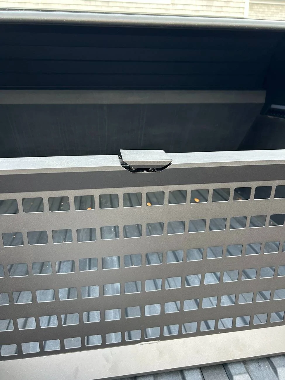

I also bought one from Teslaunch and the locking handle does not close properly. I tried to get a replacement from Teslaunch. Joe the rep said ok but it never arrived and they stopped communicating. Seems to me they are having a lot of issues with the cargo divider, it is not working properly. I would never buy from them again. Lousy customer service.
