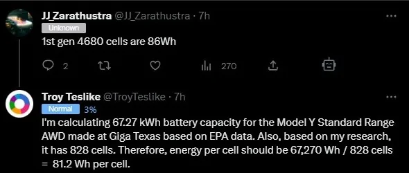

As always, Troy with wrong info
Current 4680s are 86.5 Wh, making the 10% increase be 95 Wh

Again, Troy confusing things
One is usable energy, another is gross capacity, there is a bottom buffer
When we talk about pack size it should be the gross capacity
When we talk about "Cybertruck Range Prediction" tho that is based on usable energy.
