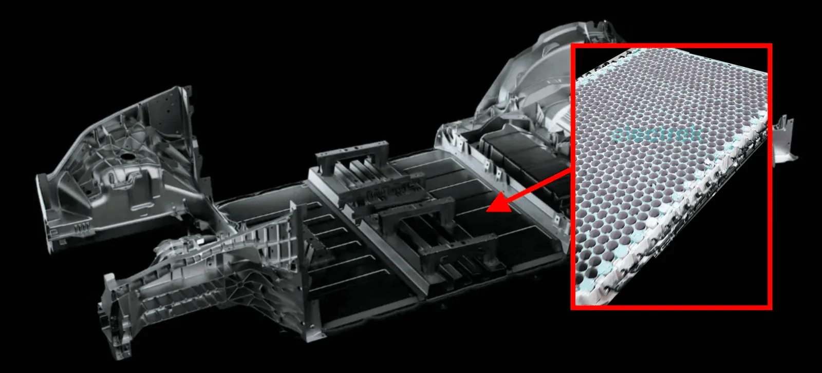

Interesting, if they only use space in the passenger floor they would probably have to double stack. Given that in all other Tesla models the battery pack is between the front and rear casting I assumed using wheelbase was a decent barometer. Glad the post sparked some conversation.
They will certainly double stack and not pass the midgate with the batteries. Previous post on the recent BIW images clearly show a deep recess for where the tonneau cover will coil up and prevent the continuation of the battery pack. Also, watching the video of Franz's kids getting in the back seat you can clearly see that there is no significant depression in the floor relative to the door threshold. And images below the vehicle seem to show the lower protective plate about flush with the exterior body panels indicating that pack will be about 8" thick, which lines up relatively close to the double stack idea. Also, the CT will experience some of the largest forces of any of their vehicles due to its size and use. Having a thicker structural pack greatly greatly enhances the structural strength of the pack the formula for the moment of inertia of a rectangle, which i assume the structural pack will resemble in section, is
Tesla Roadster 2nd gen Cybertruck Range Prediction + Cell Calculation + More [Sources] 1689710021714
with b being the width of the pack and d being the thickness of the pack. So you can see that the thickness of the pack exponentially increases the strength of the pack. The stress at any point in the pack is inversely proportional to the moment of inertia. I am 95% sure that we will see a double thick pack that only extends from the front fire wall to the mid gate. Any interest in rerunning the calcs on that area with a couble thick pack?

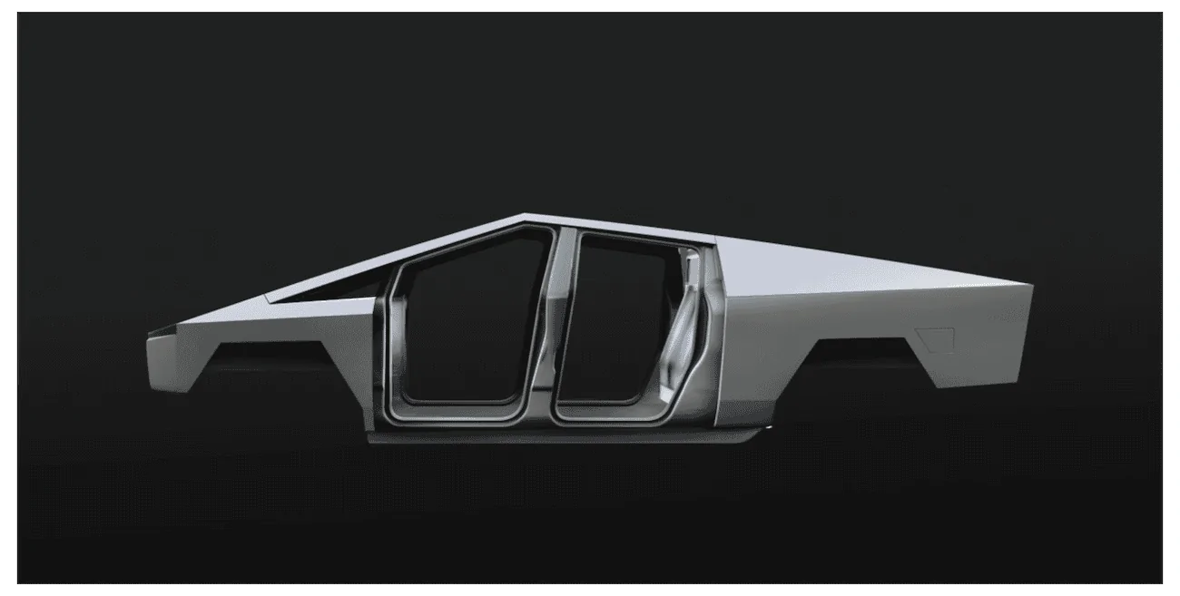

My bet would be for longer range options that they will add an extra hump of batteries under the seats and possibly around the frunk or that vault in the vault where I am showing in red below. It is very clear that the tonneau cover will be in the location i have shown in blue

I don't think a double stacked 4680 works well as a structural pack, so they will stick to a single stack. It would be very difficult to make a two layer pack but with different cell numbers for example, because to be structural they would have to exactly overlap one layer of cells over another. It would also mean they would have to do two interior layouts or have a false floor on top of the single stack. Both unlikely.
But according to my rough calculations I think we'll get a 420mile range version on a single stack with a 10% buffer, if you use the same setbacks used in a MY 4680 structural pack on the CT floor pan.
This is all very approximate though, given that we really lack any real figures on actual CT consumption. Without that calculating range is like asking how long is a peice of string...
You dont need to perfectly stack them although that would not be an issue. And if stacked there is likely going to be a seperator that could transfer unperfectly stacked loads. And generally in a rectangular shape the middle axis is a neutral axis without much force acting on it. The upper and lower diaphragms have the most for acting on them. It is very likely that they will stack the packs.

Thanks for drawing it out, that would definitely require a double stacked pack. In my opinion Tesla will do this:
The structural component of the pack, their big breakthrough, will be casting to casting. (Again in my humble opinion) The rigidity of the Cybertruck will be next level for a truck.
In summary:
you forgot to leave room for the coiled up tonneau cover. the pack will probably start 14"-16" in front of the rear wheel casting. probably in line with the rear door seem.
