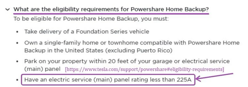

We have plans to build a house in the next few years and I'm really trying to sort this out in my head so I can lay things out for an easy install.
I was planning on having all electrical appliances (induction stove, instant hot water electric tanks, etc) and two EVs so I had 400 amp service planned.
No solar option as there are too many tall trees around the house that can't be trimmed per codes.
I guess I just need a gateway and put it in that 'open area' (see pict below) in my basement?
Any advantage to putting a single powerwall there instead of just a gateway. ie. I know the powerwall has some built-in features to enable the bi-directional Cybertruck V2H?
I have two 200 amp panels and I guess I would figure out what my critical loads are (1 heat pump in walkout basement and 1 heat pump upstairs, some main lighting, ... those dang instant hot water taken take high amps tho so need to leave those off).
>>> Would welcome any thought !! <<<
