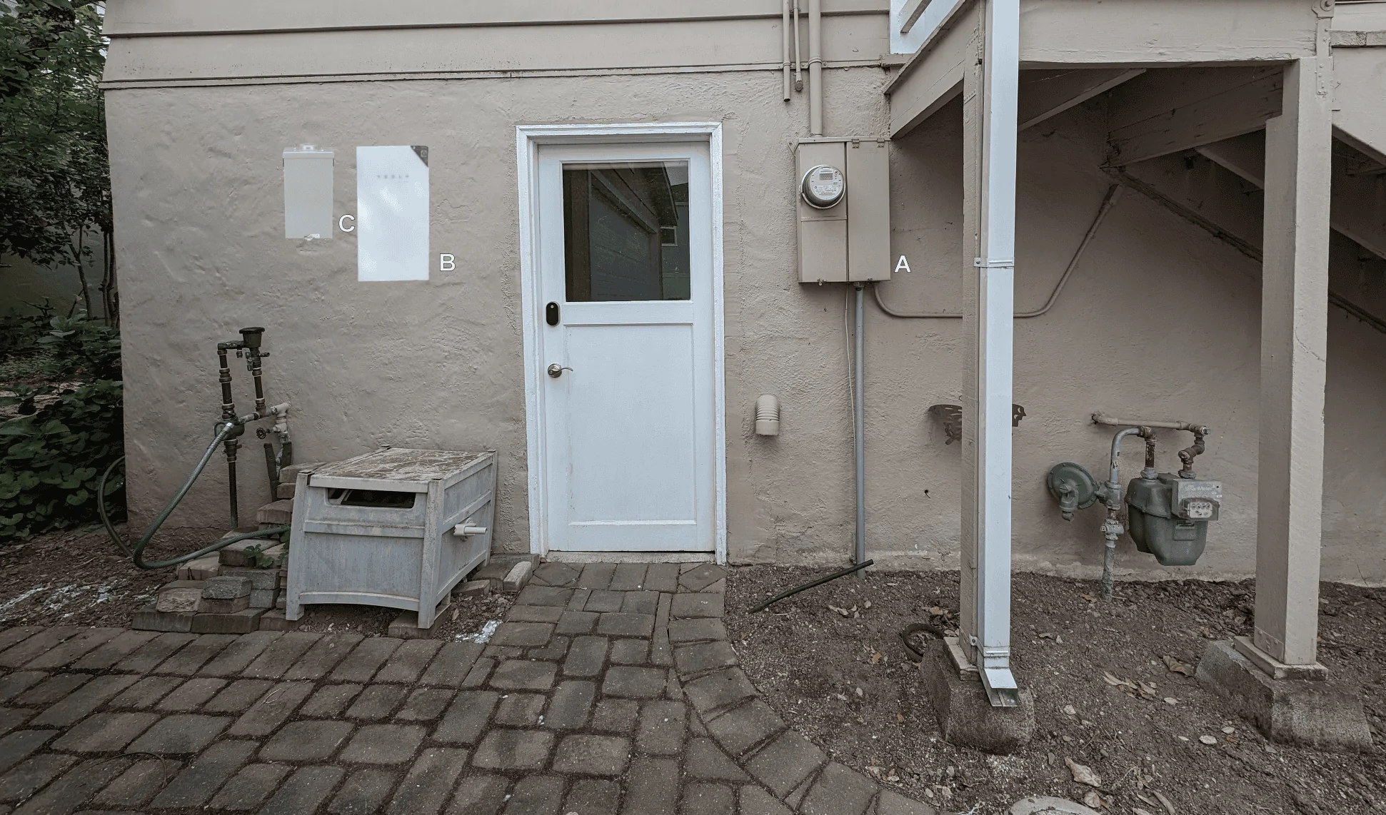

Looking at the diagram they provided, I’m not sure if the garage will be backed up and if they are planning to run the wires for the 60A circuit in the same conduit that is currently being used for the load center in the garage.
Almost looks like they are adding another load center (C on the diagram) on the house and replacing the one in the garage with a 125A load center. Maybe C on the diagram is the existing 125A load center built into the meter enclosure?
Tesla Roadster 2nd gen New Powershare Install by Tesla - Questions - CA fsuPxEuFt5ci82mM4avtD0OmZiXwsLlap26_gpzFYUvpFT31xA
Not sure what the RELAY is or why it’s shown on the left side of the door. He said the Gateway would be installed under the stairs.
Tesla Roadster 2nd gen New Powershare Install by Tesla - Questions - CA FgaltP-OMwckbIAQWJSCP3_9Dv9QVLQVDG5blQtOHdzHVFFNbk
Thinking it would be something like this.

They had said it would be mounted under the stairs but now they are saying that nothing can go under the stairs.
Where is everything going to go then?
They also seem to be adding another load center "C" on the drawing. Two large boxes on the other side of the door and the conduit back and forth to the existing meter/load center?

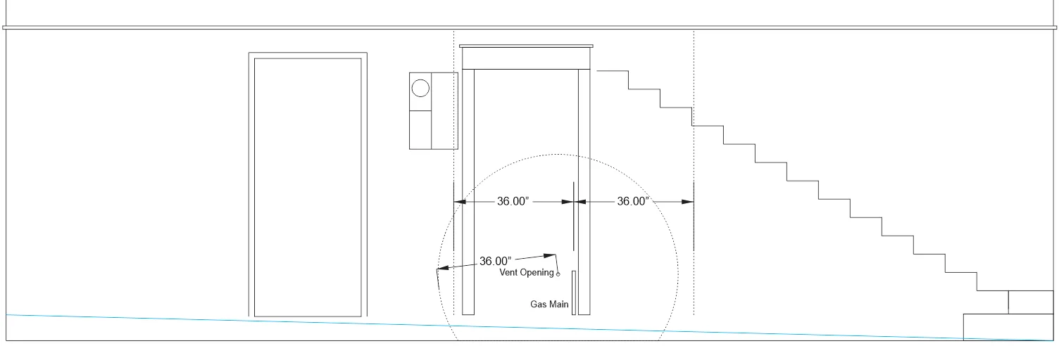

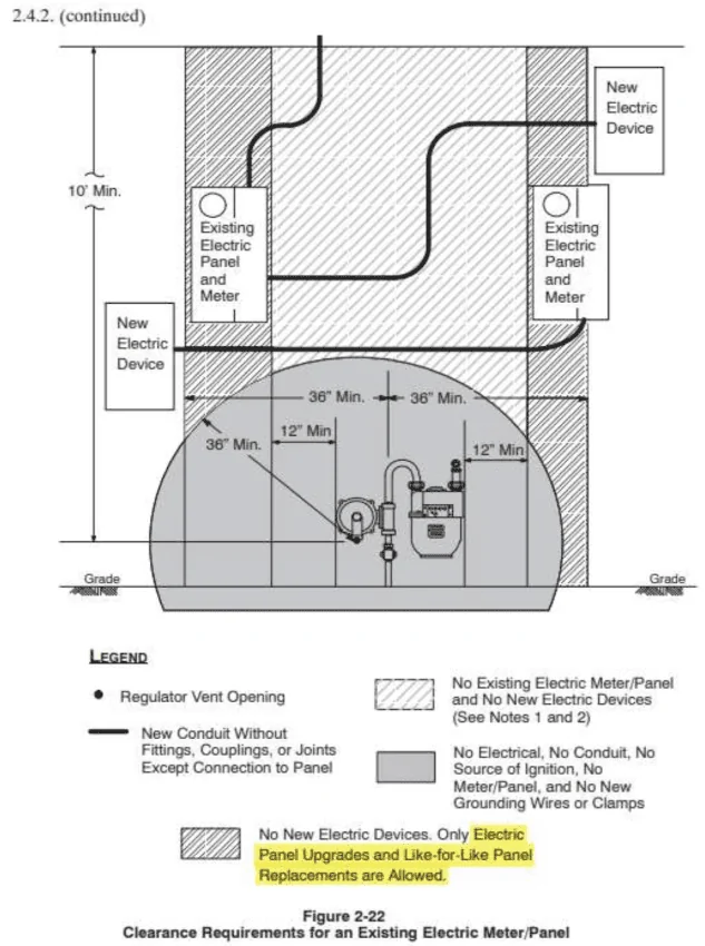

The City was ok with the NEC Working Clearance but PG&E also wants 3' on either side of the main gas line and a 3' radius around the vent opening for any new electric device, I don't think anything can go under the stairs.
Is it worth checking with them?
If my math is correct, the existing panel is already a little into the 'Existing Electrical Panels and Meter' only space.

Not even sure the can go on the left side of the door with the water pipes going in and out of the house there.
Tesla Roadster 2nd gen New Powershare Install by Tesla - Questions - CA 1714105995064-kd
If they can run the wires inside maybe they can go around the side. Seems silly when they could go right next to the existing load center save for the codes/safety.
Tesla Roadster 2nd gen New Powershare Install by Tesla - Questions - CA 1714106217046-6k
There seems to be some odd excess things on there that should be in the gateway.
That gas regulator is really screwing with you - you can't install panels over it and your current panels are just tight spaces. I wouldn't want to be a worker leaning over it.
Can you use the wall on the inside?

"excess things"
The new third load center 'C'? I think it is because there is no more room in the existing load center. But I don't know how they are bypassing the current circuits to send only utility power only to the gateway and not energizing existing circuits. They show a relocated breaker in 'C' going out 'To (E) Loads'. I think that is going back into the existing load center that will still have all the breakers for everything in the house.
"wouldn't want to be a worker leaning over it."
The gateway and load center 'C', if not too large, would have room in front of them. Not a lot but you would not need to reach over the gas meter. The main thing is that PG&E don't want any new electric enclosures within 3' and I don't want the extra risk either. It would make it a much simpler install though.
"Can you use the wall on the inside?"
You can but then you need to meet the NEC workspace code. They do have an exception for height in older homes if under 200A but you can not have anything in front of it (ever) and I currently have a dryer on that side of the door and a washer on the other. Tesla also said that when other projects want to do something like that with a Powerwall or something it can not be in the living space or needs to be walled off and fireproofed.
