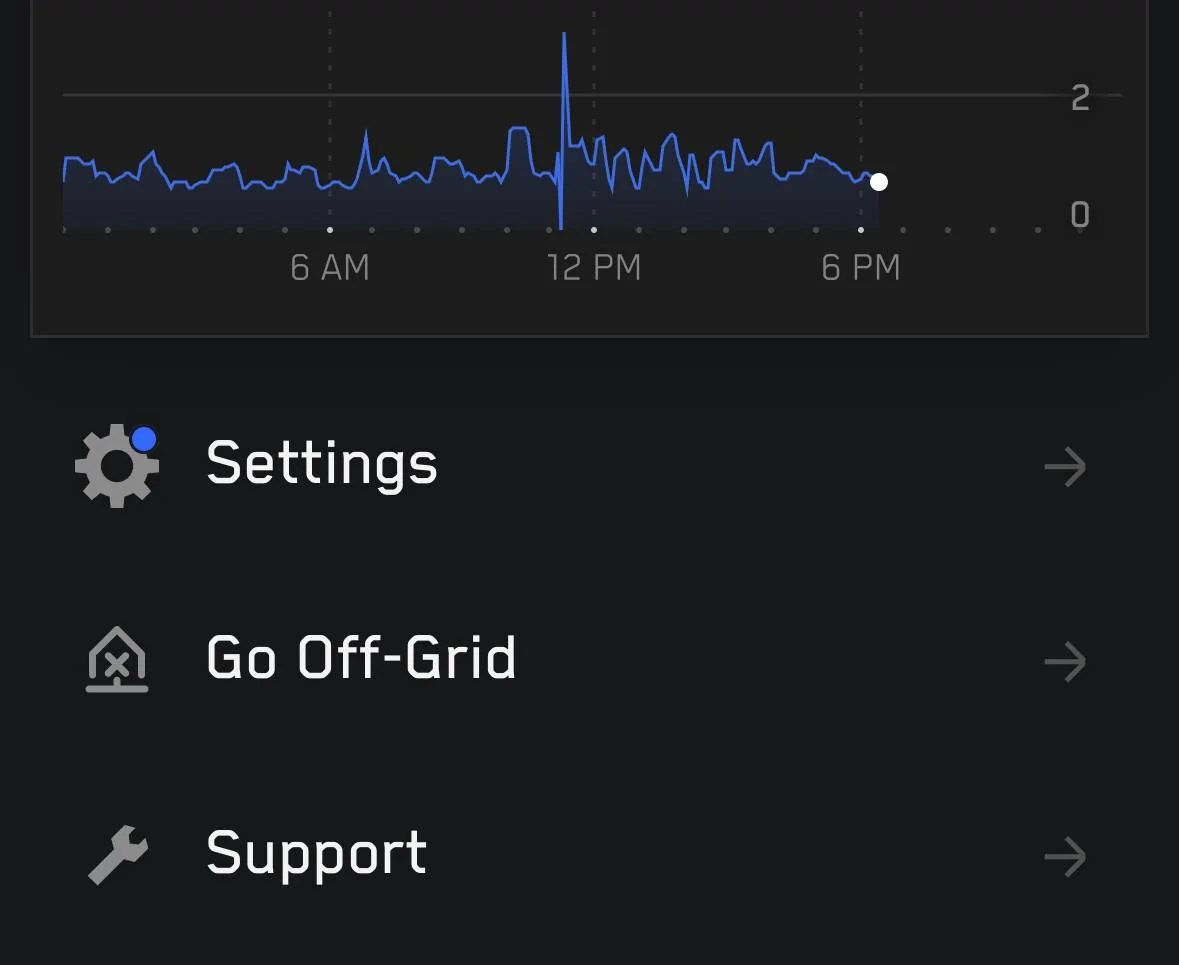

I had my powershare gateway installed a few months ago, but only just a few days ago got a new control in the app. It's called "Go Off-Grid" and it appears to be designed for testing the powershare setup. Do you have that in your app?

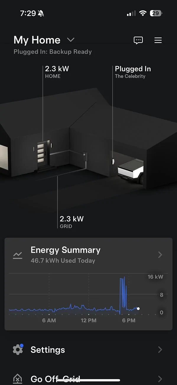

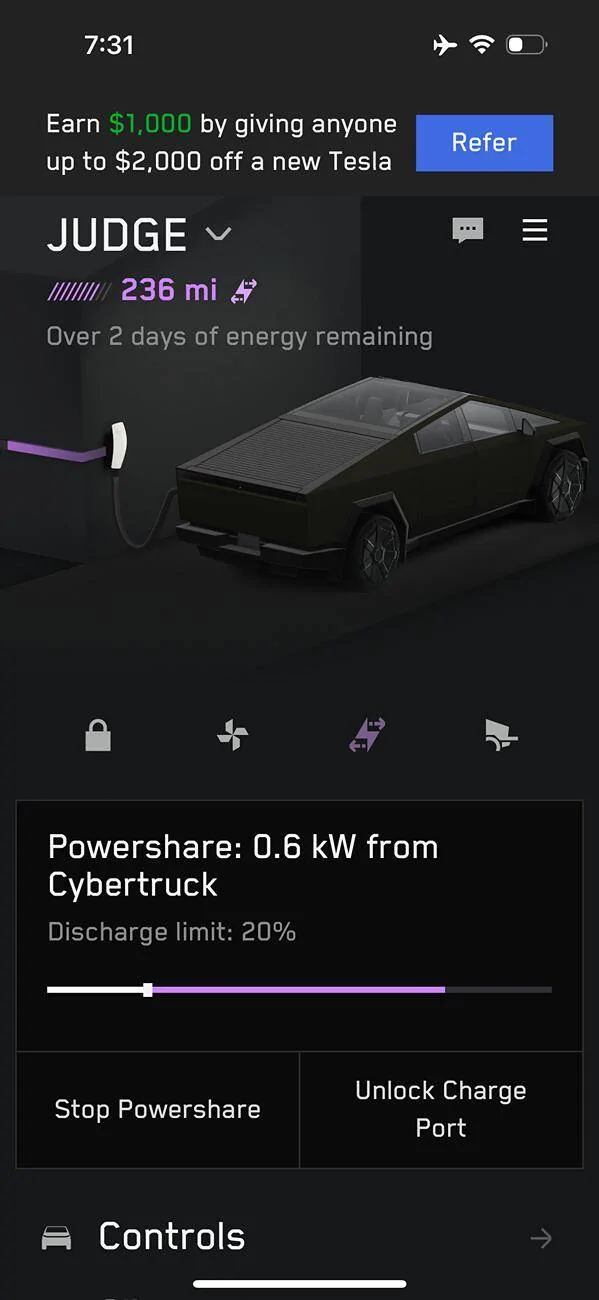

When I did was simply turn off the main breaker in your picture that would be number one. What happens is the universal charger that they install turns purple glowing and then you plug it into the truck and it switches over but you have to have that screenshot to show that the software is enabled

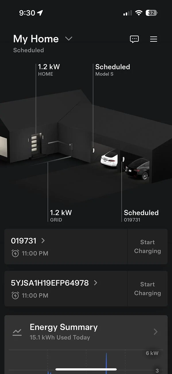

I’m still waiting for Tesla to turn on my PowerShare. Been almost 7 weeks since install and still no update on my truck.
I had QMerit do my install, but found that I needed to add the system in the app. Play around with the options to see if you can add it. Perhaps folks are waiting on Tesla, when the end user actually needs to add it to the app to activate? QMerit said nothing of this, I just found it on my own. Now I see this in my app.

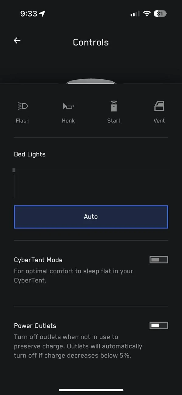

This is what I currently have showing on my app

This is under controls from my truck. I’m totally missing the PowerShare backup button. So I don’t think it’s on my end
If you don’t mind my asking, what screen shot shows that PS is enabled?

Lastly, to answer your question...open your PS box and turn off the bottom right breaker while your truck is connected to its house charger, that will trigger test to see if it's working. In my case it was a 5 second or so delay, then all workerd perfectly.
Have you always had this data flowing? Meaning what your house uses and what is coming from the grid. Or was this after you did the “off grid” set up. I have never had this data and when PowerShare was installed we did test PowerShare and it did flip over to the Cybertruck and powered the house.
