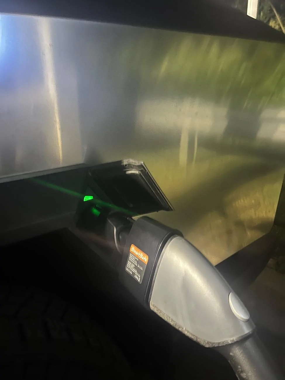

Here is my shot at it. Just used the universal wall chargers NACS to J1772 adaptor and used another J1772 to NACS.
Will test it tonight and see how well it charges.

This probably isn't going to go well. The J1772 adapter is built for <100A (more like 48A) AC charging, not >500A DC charging. Especially worrisome if you use a 800V charger...

I was also not sure if it will work or not but it did worked!!

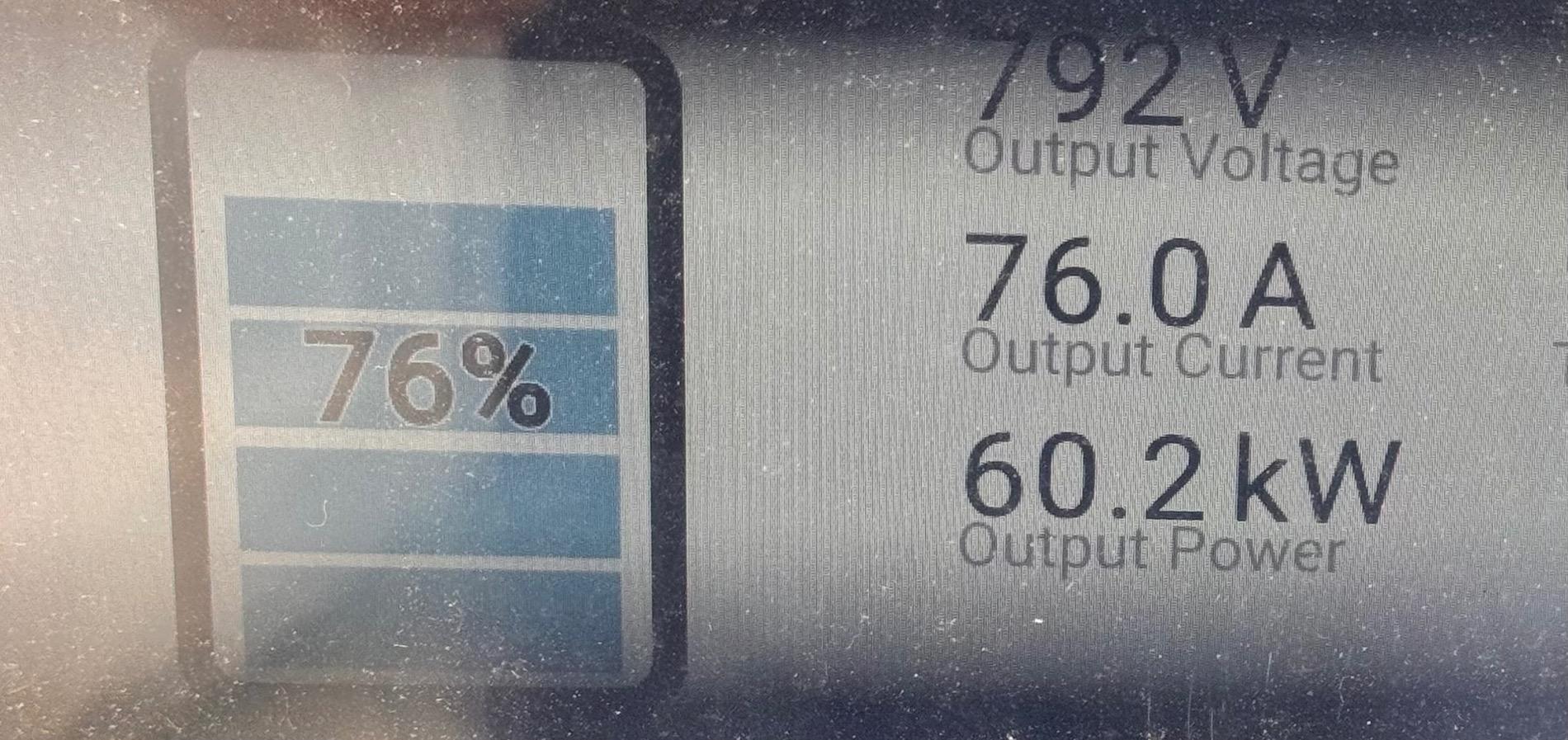

I used the Kyle Connor workaround on my last road trip. The place I was staying didn’t have (220 volt) power available and the closest supercharger was 20 miles away. A ChargePoint station (62.5kW) was only 2 miles away. The adapter setup (EVJect + Tesla CCS) worked perfectly.
Using it everyday is up to you but it came in handy on my last road trip with the Cybertruck.
