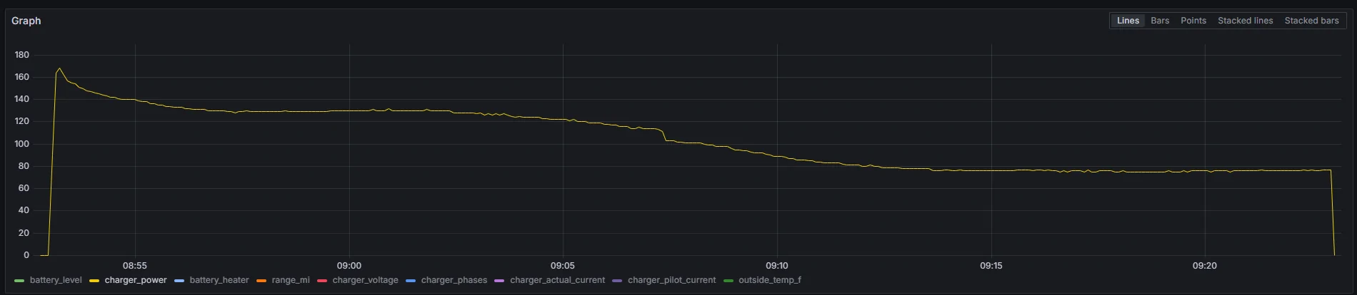

Extremely helpful, solution, and information sharing. Love the pioneering.Charging on an Electrify America CCS unit right now. Arrived at 40% with the battery preconditioned by putting in a Supercharger as the destination, driving to the Supercharger and then to the Electrify America unit
Saw it hit 162 kW when I first started the charge then quickly went down to 142 kW. Will report the full charge curve when I get home and can snag the data from TeslaMate.
EDIT:
Charge curve from TeslaMate below. Even with the preconditioning of the battery it had the battery heater on from 40% to 70% (the blue line on the graph). Little hard to see the charge rate on the graph, added some different views as well.
