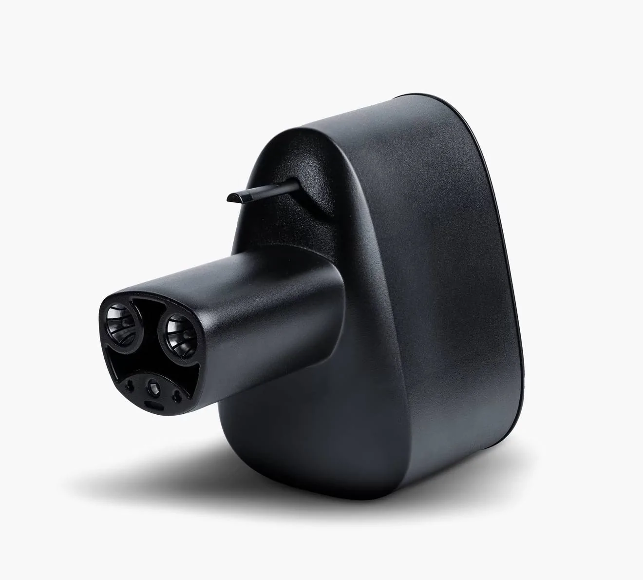

Discovered the Tesla CCS Combo 1 Adapter does not fit the Cybertruck charging port. Anyone know if there will be an extension or new version made for the Cybertruck?
Which brand did you get? Does it fit other Teslas and not your Cybertruck?

I bought the Tesla adapter. It works fine on the Model Y because the port is inset only about 1/4”, but the Cybertruck port is inset more than 2”.

i seem to remember per out of spec videos that currently you could A) rip off the fairing around the wheel to make it fit. Or you can use the EVject adaptor with the OEM one to make it fit. Neither is a great solution, but using a 3rd party adaptor seems to be in the same boat as evject as you are both using a 3rd party device AND having to pay more for something non-oem.

Some have used the EVject "escape connector" as an extension from the Tesla CCS adapter to clear the Cybertruck fender. As of 2/25/2025 website shows "v2 pre-order."
