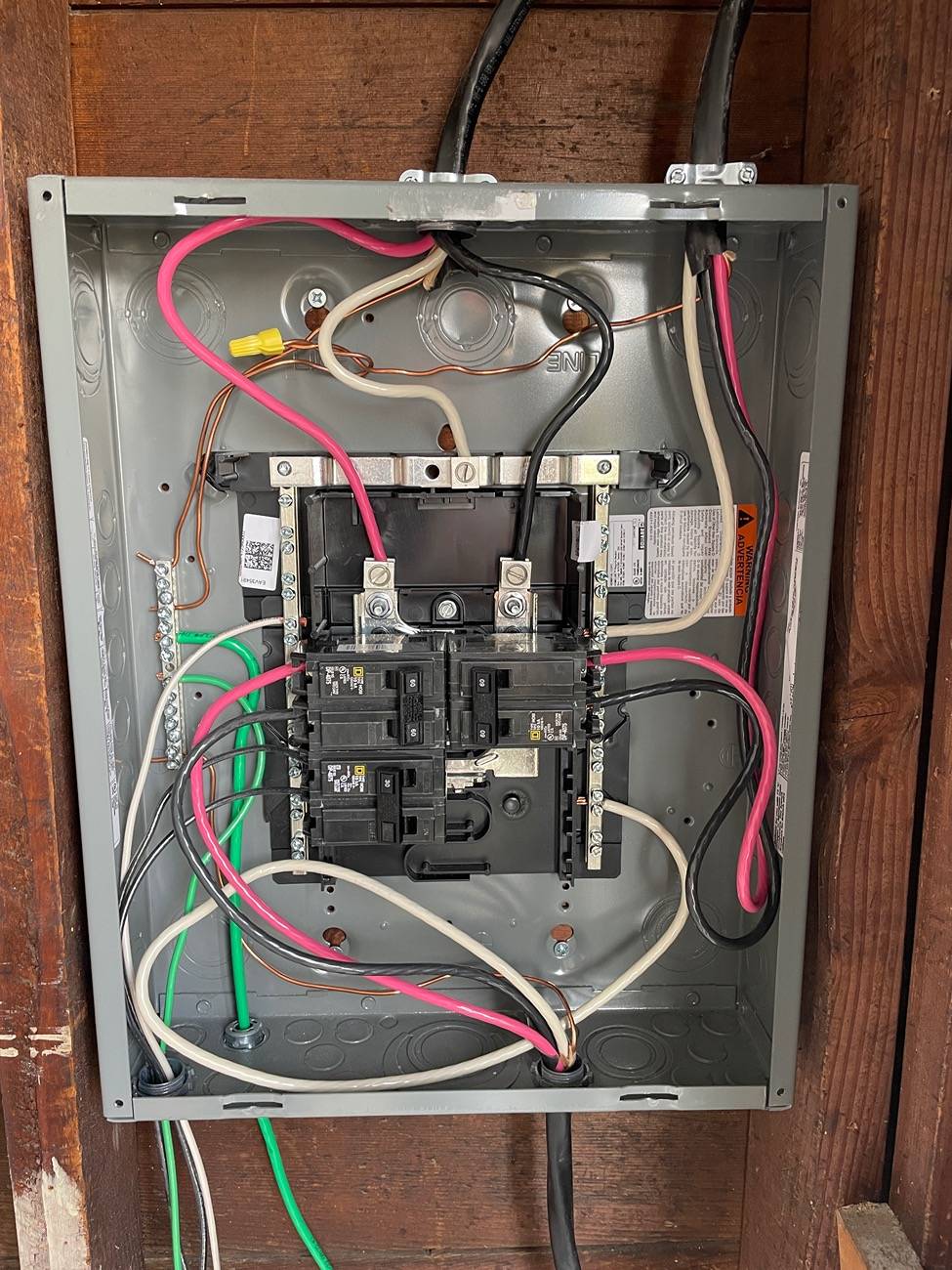

As others have said your current wiring for your WC will work for your UWC.
The comm wire also is correct, I have a 22 gauge 4 wire running to my UWC.
I have a FULL panel backup using the PowerShare.
Also Group Power Management is NOT possible while using PowerShare. I am not saying you can’t put it on your other WC, but PowerShare will not work if you have your UWC setup in the group power management system.
I have 3 WC, one being the UWC. My to WX are setup in group power management, while my UWC is just set for standalone.
ALL 3 wall connectors are using the same 60amp breaker going to a sub panel where each has their own 60 amp breaker for full power when running by its self.
The only issue is I can not charge my Truck using the UWC while any of my other cars are charging the other WC as it will trip the breaker. So I have schedule charging for my other cars using the group power management. Yes it sounds complicated but it isn’t.

Photo is before he installed the 3rd breaker for the UWC.
