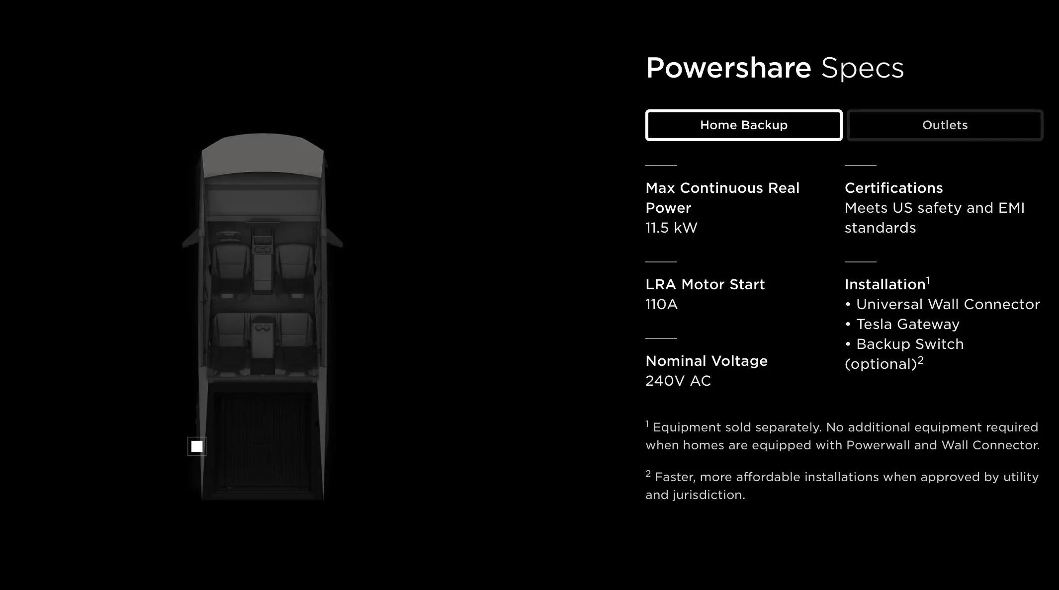

I want to order the Cybertruck RW, really dig the powershare, is this feature included in all models? on the pic I took from Tesla site, says no addiontal cost if if home is equipped with powerwall and wall connector, I have both, so I'm all set? I see it as getting a truck with an extra powerwall for my house

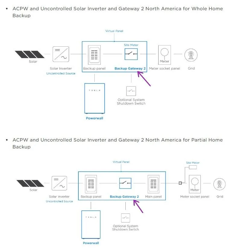

Sounds like you'll need a Tesla Gateway that controls the flow of electricity from your utility company/grid vs your Cybertruck.
https://service.tesla.com/docs/Publ...UID-D71DFD63-1414-4915-B7A5-7E48703100DE.html
