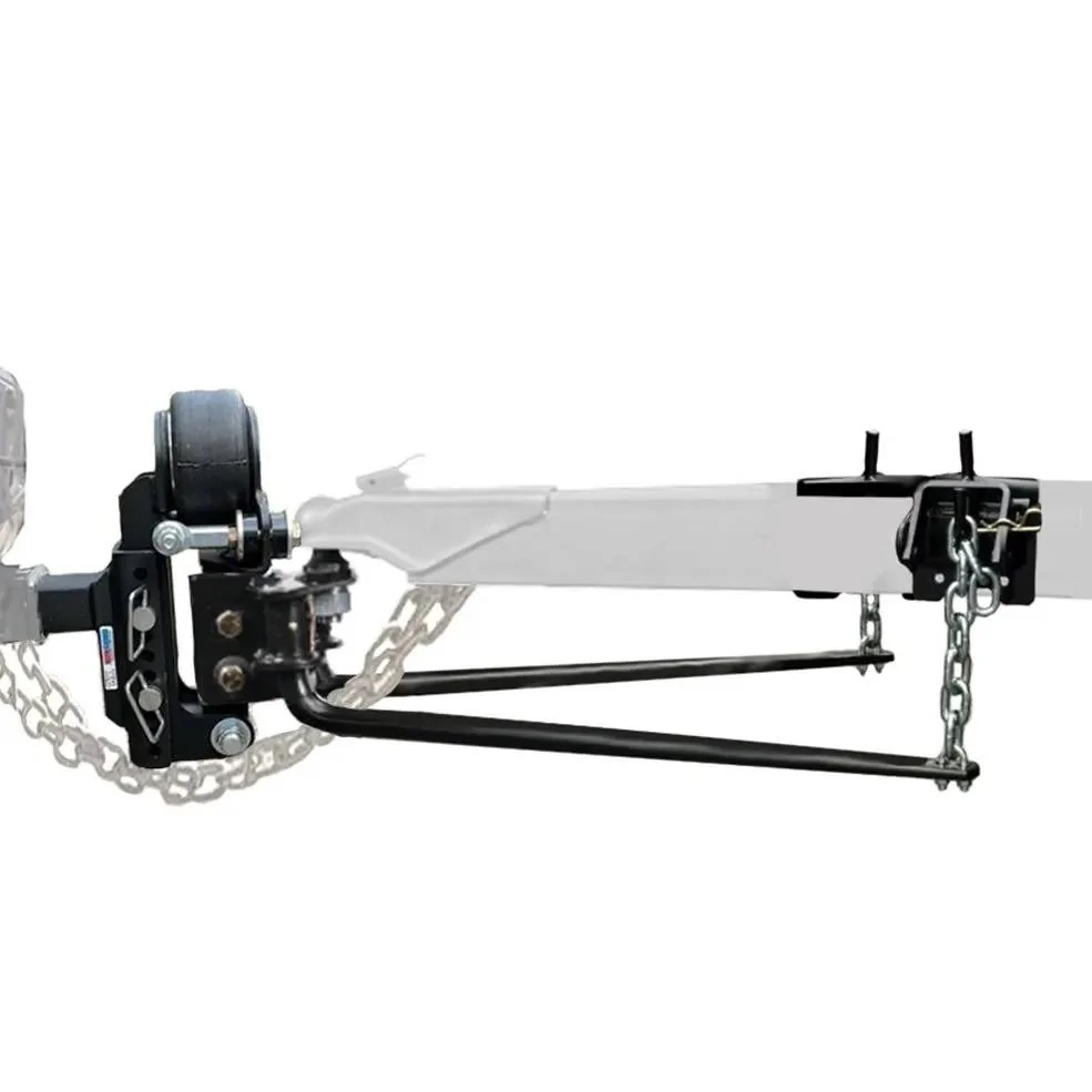

Hey all, I’m probably going to try out the shocker impact cushion hitch. It’s well suited to the Cybertruck’s load specs, and most of my anticipated towing is lighter loads. This isn’t the full airbag setup, but should reduce cyclic loading of the truck frame substantially. Yeah, probably overkill but I’ll have properly matched equipment to the truck and can accommodate any basic towing needs. I’m not planning on much more than my single axle utility trailer that maxes out at 3500lbs. But should that change I’ll be set with a quality hitch that accommodates 12000lbs and 1200tongue weight, above the trucks max. I’ll report back after some experience with it. Not even on order yet.
https://shockerhitch.com/product/sh...-ball-mount-options=black-combo-2-2-5-16-ball

It seems like these units would help with impulse shock from mechanical slop [Edit: actually, any differential movement by spreading the impulse] , but also [potentially] make tongue torque worse due to the longer pin to ball distance.

Yes, that’s a valid consideration about moving the hitch ball back about 3 inches. I had grok help me through the math on it, and reducing the tongue weight limit to about 1000 pounds is highly conservative. In reality, my 3500 pound trailer will likely never get above 500 pounds of tongue weight anyhow it’s definitely something to be aware of and a tongue weight scale might be useful if I think I’m approaching any sort of limit. All good things to be aware of.
With regards to subframe failures or gigacasting failures due to exceedance of tongue weight limits, (such as in the clickbait videos) it’s worth noting that an F150 or Silverado will suffer plastic deformation to the subframe or hitch assembly at similar or slightly higher weights applied directly to the hitch ball as where the Cybertruck failed.
The bigger issue here might be cyclic loading over years and years of towing. I think that the rest of the truck will wear out way sooner than the point at which you’ll face a catastrophic failure due to work hardening from cycle loading that fails the subframe.
It’s important to keep in mind that the cyber truck frame failures that were demonstrated in the click bait videos occurred with a dynamic load that was over 10 times the rated load capacity.
I just ordered the hitch ball that I linked above and will be happy to report back with my weekend warrior Home Depot and municipal dump towing experiences. At some point, I will likely do a five or 6 Hour Drive with the trailer and can report on that too.

Yeah, you shouldn't have as problem with your trailer.
Not sure what Grok was saying, Tesla specs out 7.3 inches pin to ball, I think it's more like 8, but haven't made a test jig accurate enough to verify. 11 verus 8 for the same torque at the pin is 800 vs 1,100 pounds. However, while Tesla used that in their cargo load calculation, the actual fulcrum is further away, so the numbers are conservative.
Regarding the "failure" video, it was around 10x the static tongue weight, but actual test loads are around 5-6k. Still gives a 2x factor for fatigue.

Might have been an inconsistency on info on distance of pin to ball. I’ll verify before going anywhere near limits, of course!

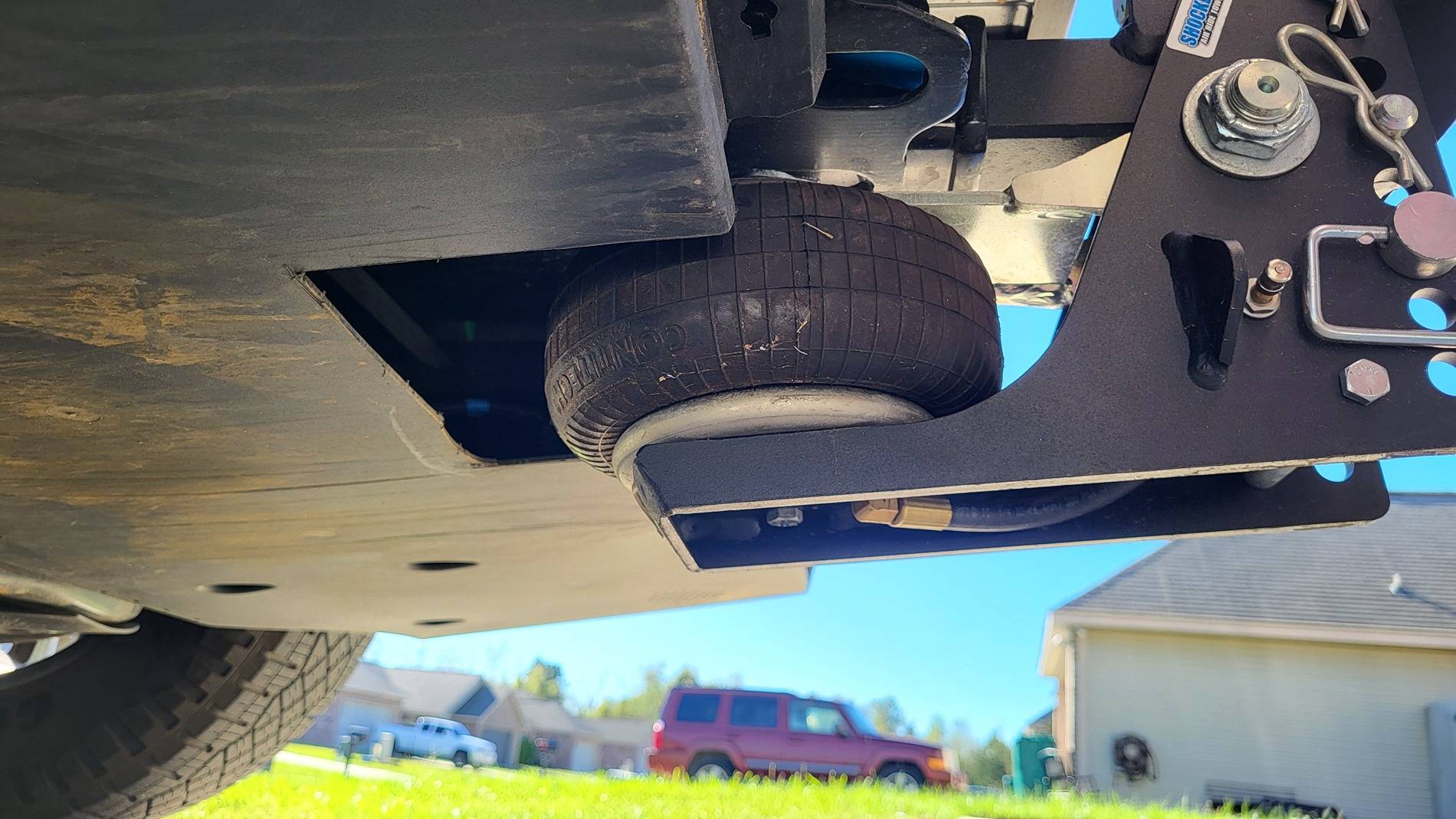

The shocker hitch is great. I have used it for a few years starting with my model X. It is a completely different experience towing, and you don't feel anything behind you. No jolts, bumps, jerks when the trailer goes over road imperfections. I find it also improves stability when road conditions are slick or wet - tire grip can be used for actual traction instead of dampening out trailer jerks.
Folks that advocate against this simply haven't experienced the bliss of a normal ride while towing. You won't go back.
I got mine from ebay as a remanufactured unit from the same folks that make them. From what I could tell, it looked brand new and was just a few hundred cheaper. I guess they want a piece of the used market.
One upside is the ball is extended an inch or two, which for my trailer is enough for me to max out my steering and not clip the truck. One less thing to worry about.
Only downside is I had to cut out part of the lower valence. I leave it attached to the dust cover by the middle of the three twist locks. When I am not towing, it still fits and covers everything up just fine. Be advised the pedestrian warning speaker wire is in the path of where you cut, so you first want to reach in and ziptie it to the top of the bumper hitch thingy so its out of the way.
Huh? If you are using quality towing gear, everything should fit tightly enough that you don't feel any jolts or jerks when going over road imperfections. If it was jolting/jerking I would want to know about it because that implies something is wrong.
