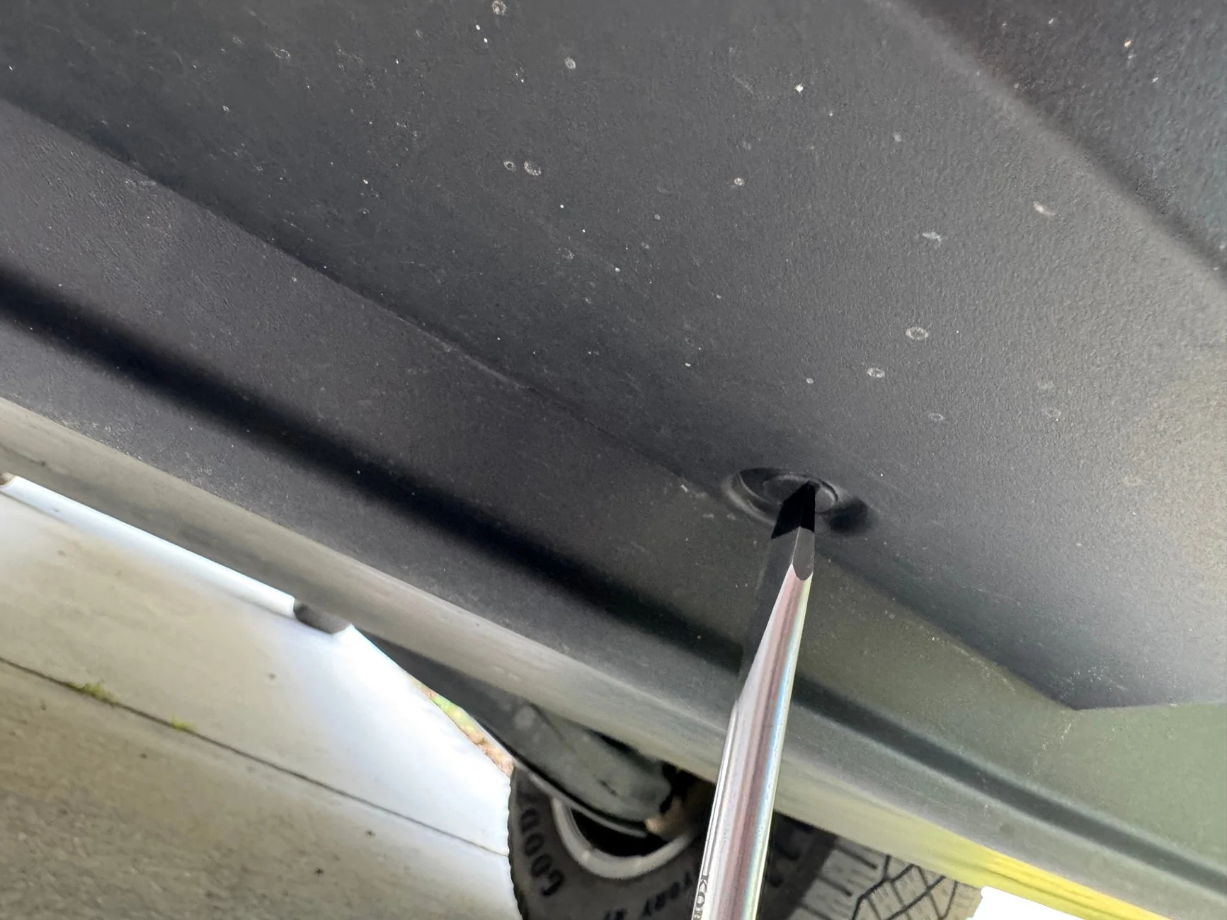

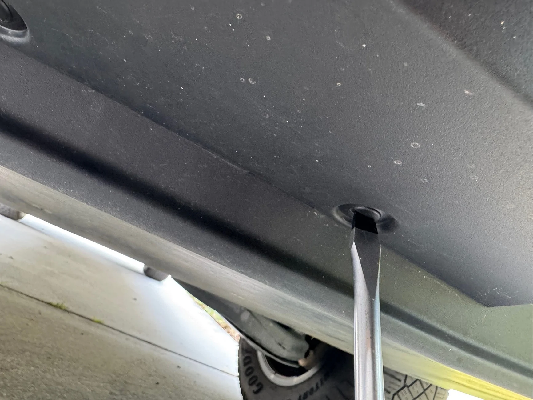

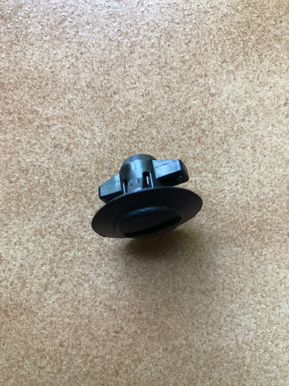

My screwdrivers did not fit very well so I made a tool by grinding one carefully so it matches the fastener head. It would be nice if they had little handles on the fasteners.

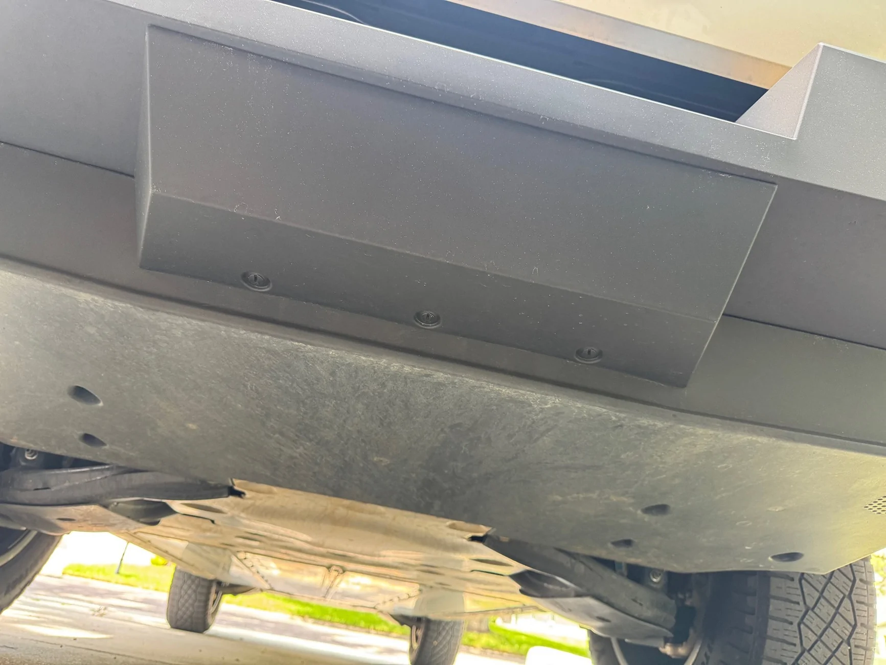

Side note: you must be lying on the ground to do this! So place a mat!
I set the height to High, put a small towel down, and just knelt. There's no wrong way to do it though, whatever is the easiest/most comfortable for you.

I do it frequently, but still forget which way to turn reaching up and doing it blind. I’ve debated replacing with thumb screws, but I don’t want it too obvious for someone to take. Still worth it to not worry about running into the ball like I would with my old truck.
Turning these takes very little effort, so just trying it both ways (without overly forcing it) quickly shows you which way it turns.

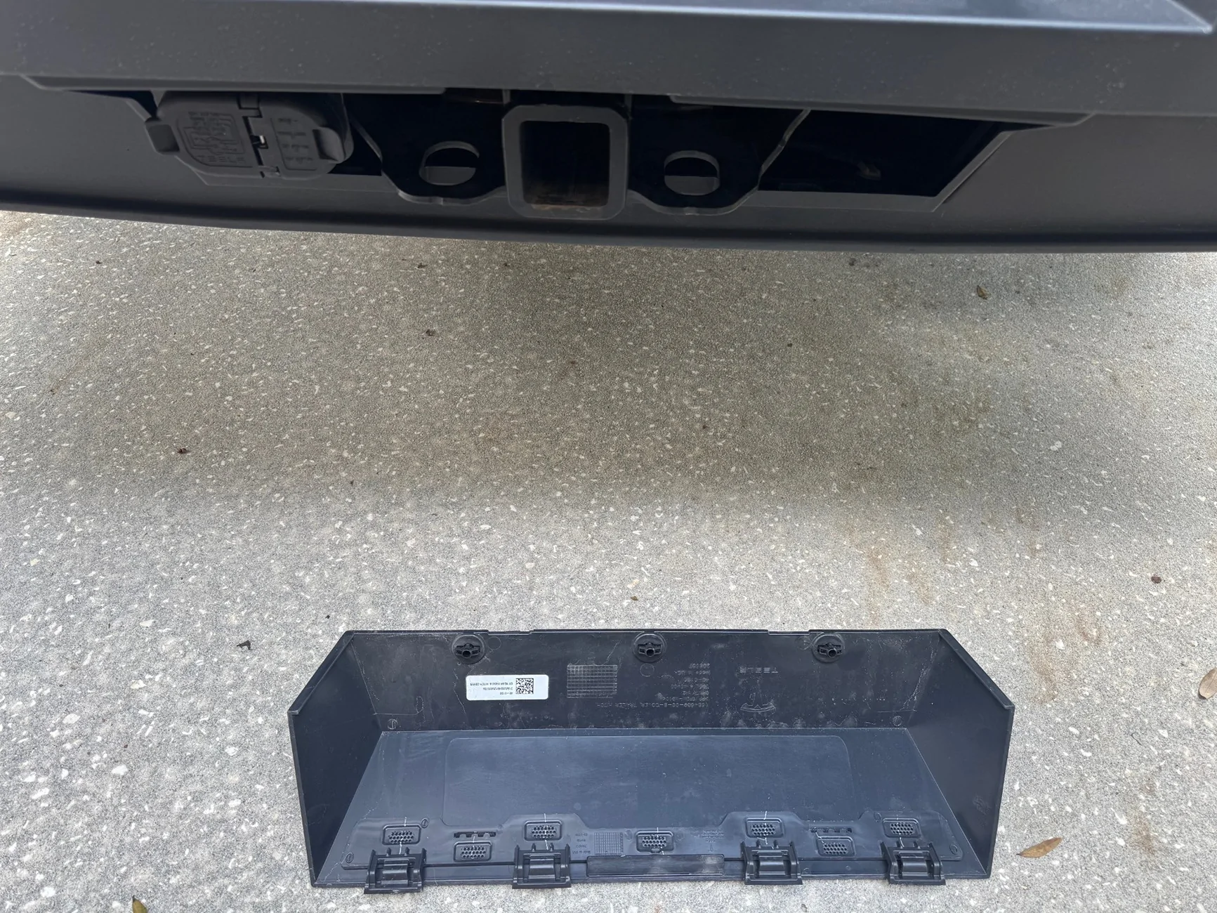

Thank you. Are we able to just leave the tow hitch on there and not put the cover back on? Would it cause any type of damage?
I tow alot. Removed the cover when I bought the truck and have not put it back on since. No problems so far, 15 months later.
Totally agree, should have mentioned that as well. Besides leaving the cover off, I usually leave my receiver with the ball on it in as well. I just had to do a 2,200+ mile road trip, so wanted as much efficiency as possible, hence the reason to put it back on (and subsequently remove it once back home). Thought I'd document the process since it was so easy (and hadn't done it since early 2024 when I first got the Cybertruck).
