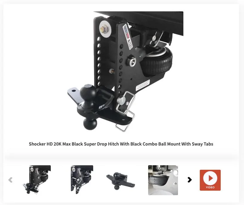

Total towing noob here and I want to get the "right" hitch for the cyber truck.
Tesla Roadster 2nd gen Which "Shocker" shock absorbing trailer hitch? Screenshot 2024-10-09 at 10.26.53 AM
This shock absorbing trailer hitch looks like a good match for the truck, especially given the frame is aluminum. While I don't think this type of hitch is required by any means it looks like a good match since it should isolate some of the vibrations from reaching the truck.
https://shockerhitch.com/product/hd-max-black-super-drop-air-hitch/
I'd like to get a trailer to be able to tow things like side-by-sides/ATVs and maybe even a smaller camper one day. If I get the range battery then I would need to tow whenever I am picking up 4'x8' sheets of things so a smaller trailer would make sense given that some off the bed space will be used by the range battery.
Has anyone used this product or have recommendations on which options work well for the CT?

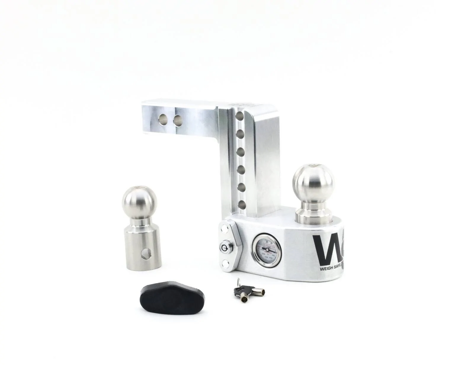

I use this:
Tesla Roadster 2nd gen Which "Shocker" shock absorbing trailer hitch? 1728569598591-l
https://www.weigh-safe.com/product/weigh-safe-drop-hitch/
A bit on the pricey side, but I towed my 18' car carrier with a UTV and empty, and get no vibration whatsoever. Don't even have to crank the jack stand, just drive under it in entry, then raise to MAX height, lock in the ball, retract the jack with the spring/pin and lower back to normal height.

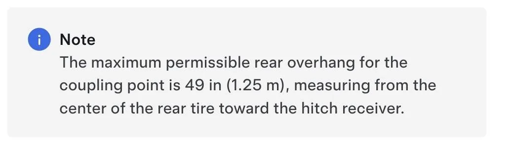

FWIW, the Cybertruck manual calls out a maximum rearward ball position of 49 inches from rear axle. That corresponds to 8 inches from pin to ball.
Rearmost body point is 46 inches.

Shocker Air Equalizer & Chain Style WD Hitch 12,000 lbs GTW for 2-5/16 Ball - 8 Hole XR Frame (#SH-7002/SH-7500)
Everyone look at the shocker hitches that have the bag up front if you need to equalize your trailers and/or its load.

What drop length option did you use for the CT? 4" / 8", etc?
Leemanpa
Lee
Jun 12, 2024
61
Tomball, TX, just NW of Houston
wa5lee.com
24 Toy Tundra, 24 Suburban, AWD CT Grey/AT
Emergency Communications Instructor
I originally got the 6"... But since the hitch could not fit as an 'UP' hitch due to a 1/3" inability to get the pin in, I had to use it as a drop hitch. So I ordered a 4" add-on, and use the top hole. Works well, using the air-rise suspension from ENTRY to HIGH (off road) to mate the ball to the hitch. Then a drop to normal, and it works like a charm...
