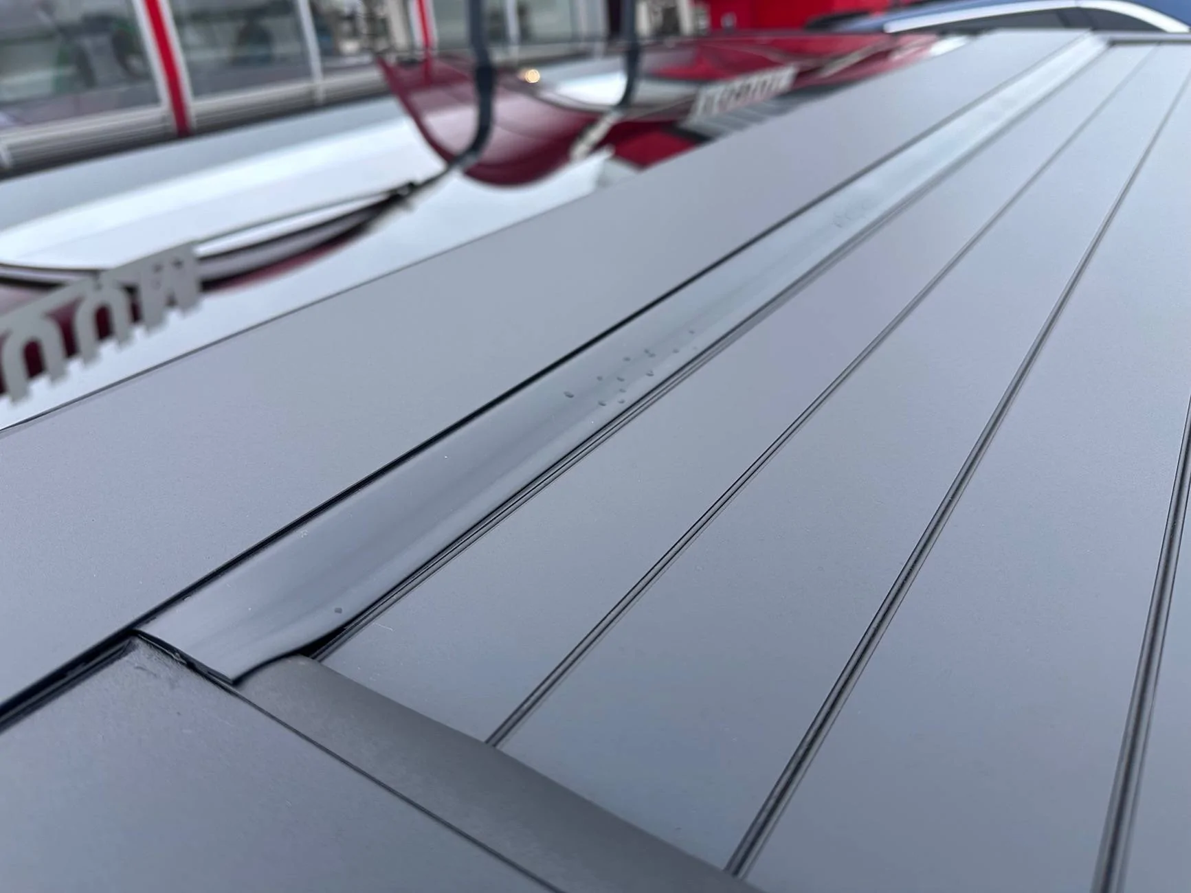

I finally found a way to make the bed of CT waterproof! After trying several methods of seals, I found one that can snugly fit in the existing channel and cover the gap. See pics and search on Amazon for the seal product. Totally works even through the carwash.

Nice find! Is that near the tailgate or near the roof?

Can you redo your pictures please??!! I can’t tell exactly what you’re trying to show because of things on, or around, the truck.

Is that the back by the tailgate? Hard to tell but looks like it. Mine is perfectly sealed there but leaks at the roof slat. Told them about it in the many 30+ days at SC-it was within spec but is missing the slat. So she’s moist when it rains and flat out wet after a car wash.

This is great. It looks as though that new weather stripping piece is installed near the wide trim near the apex of the truck on the top/front end of the bed, but the photo could be of the trim that runs along the top of the tailgate. MikeFromHolland Can you please confirm? Also, how does it install? Is it screwed into place?

I'm surprised that seal fixed the leaking for you. Most posts I have seen on here indicate that the problem is the seal behind that, close to the window that is the problem. Tesla has a service bulletin where they will install another slat to cover those holes and make it look more finished, but as SCTesla said, that doesn't fix the leak. Someone on here posted a video showing how they fixed the leaking with an inexpensive seal from the hardware store placed under the applique near the back window.

Yes, for me the leak was where the roof glass met the aeroflap. Easily tested by opening the tonneau and pouring a glass of water on the roof glass. I could see it pour in before it got to the aeroflap. I fixed it for months with electrical tape, and then 'upgraded' to windshield seal tape.
This was after two attempts by the service center.

Where exactly did you stick the rubber strip? Thanks!
