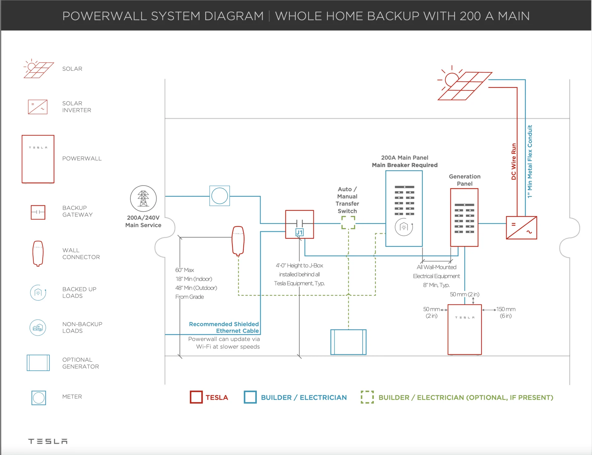

kev12345
Kevin
May 16, 2020
794
500
Canada
Ram 1500
I'm hoping they release a new backup gateway with a built in 2 way connector to mimic what ford has available. it'll simplify this mess quite a bit. no need for Powerwall, separate transfer switch and generator anymore for an entire home backup system. "get two birds stoned at once." - Ricky
