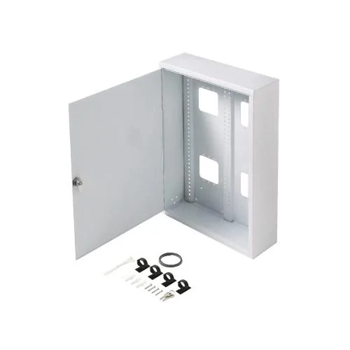

I agree, good option to put the Tesla wall unit in a lockable cabinet large enough to include the cable and if you have alarm system at the house put a alarm sensor/contact on the cabinet door.

Tesla Roadster 2nd gen TESLA Wall charger SECURITY 550-105
$70 Steren FastHome Surface Mount Network Enclosure, 19
Model: 550-105
https://www.cablingplus.com/products/steren-550-105-19-inch-surface-mount-network-enclosure
The Steren 550-105 19ā€ FastHome Surface Mount Network Enclosure is designed to house commercial and residential electronic components. It is ideal for security and networking applications. The 550-105 is a surface mount box that includes locking hardware, hinged cover, multiple knockouts and pre-punched holes, and raised mounting rails that create a clean wiring channel behind mounted modules. The Steren 550-105 19ā€ FastHome Surface Mount Network Enclosure features a white textured powder-coated corrosion-resistant finish, and offers standard hole spacing which allows flexibility for mounting modules. The Steren 550-105 dimensions are 14 9/16"(W) x 19"(H) x 4 5/16"(D).
Specifications:
Includes: (1) 550-105 11ā€ FastHome Surface Mount Network Enclosure
14 9/16?(W) x 19?(H) x 4 5/16?(D)
Standard hole spacing allows flexibility for mounting modules
White textured powder-coated corrosion-resistant finish
Mounts on surface of a wall Multiple knockouts and pre-punched holes
Raised mounting rails create a clean wiring channel behind mounted module
Captured hinge cover design for easy access
Keyed latch for positive closure and security
Model: 550-105
Specifications:
