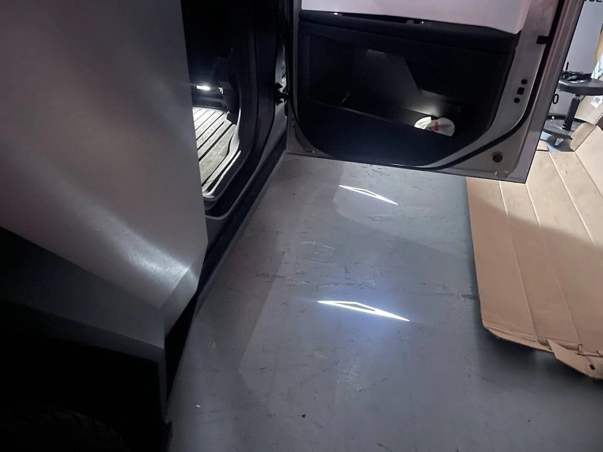

jf64k
Dec 12, 2023
866
970
I've got mine on all four doors. They work fine.

How hard were they to install?
They are easy to install. IMO, the only things you need to be cognizant of is trying to pry out the light, be careful not to damage the surrounding material (it's a tight spot), I ended up putting a rag under the screwdriver. On the back doors the wires are shorter and attached to a clip in the door, don't tug too hard. Lastly, be mindful of the depress clip when removing the original lights.
