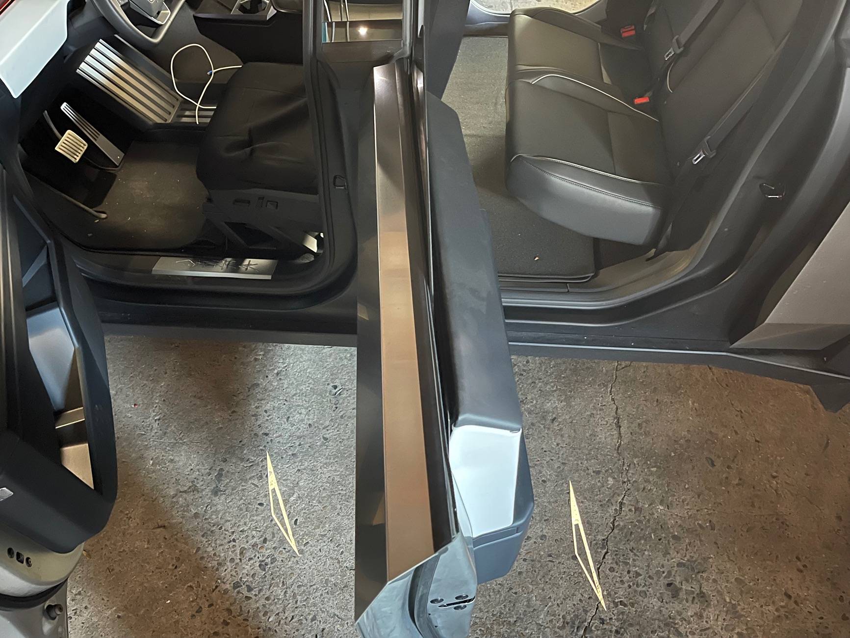

Yes they do work on the front and the rear doors. A word of caution……. The wires in the door were EXTREMELY SHORT, I had to use a pick to remove the clip from existing lights. They left me a half of an inch to get my fingers in to remove it and that wasn’t happening. Do not pull the wires!!!!!!!!!
Tesla Roadster 2nd gen Installing Cybertruck OEM Projection Lights / Puddle Lights -- Front & Rear IMG_1476
Also the lights have a R & L printed on them to designate Driver L - Passenger R. Be conscientious of this or the lights will be upside down.

Common issue with the puddle light locations in all their vehicles. We do have these if anyone has cables that are too short...the lights are wired before the door card is applied during manufacturing, so there's many times where the cables just vanish up into the door.

After the install, I would 100% have used these. Definitely a must have for anyone installing the CB Projection Lights. Would have made the install A LOT SIMPLER.

Can also confirm, the cables are short, but not unworkable, driver side is L and the same part numbers work front and rear. Yay!

I'm in medium ride height and think they are a good size. The lights do fit both doors on each side, glad I picked up two sets of two. Plenty of cable, would suggest using flat head screwdriver to release the tab, makes it much quicker and easier. Popping them back in took a lot longer than removing them as you have to tuck in the side with the connector first and then they go in at a bit of an angle. Make sure they snap in tight. No snap = not all the way in.

Just installed mine cable was short but not bad. Only tip i can give you guys is put a black tape on original light before removing it is very bright and use a flat driver. And do not pull the cable with the light before unplugging it. Other than that now i need to get two more for backs :)

Do yourself a favor and get them. If your wires are like mine, these will definitely ease the installation. My wires were basically inside the door. On a side note……… I have no affiliation to company but will take 10% of profits if thats Ok. May go to 8%.

Mine also fit all 4, but the install took way longer than it should. They pop right out but consistently the front 2 wires are very short and just feeling for the release pin. The rear 2 did fit, but definitely tighter. And 1 of the rear wires decided to escape back into the cavity and had to fish it out with my pry tool. Looks great. Little pricey, but you pay for Tesla and laziness.
